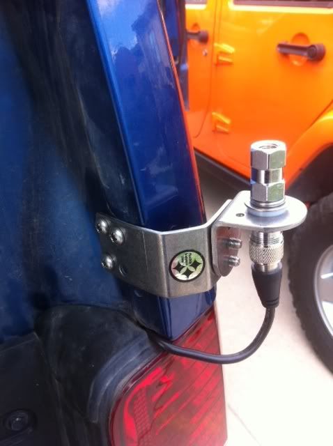

Got my Firestik Mount yesterday and i went ahead and proceeded with getting parts of the install in. Mainly, putting my first holes into the body of the jeep (its mine now!!!) and routing the CB Wiring from the unit to the back, which was pretty much cake getting the wire underneath all of the plastic pieces. Only slightly difficult part was getting the cable past the rear seats as the seats themselves dont let the plastic siding pop all the way off. The mount fits great, tho i wish i put it slightly lower and the gate rubs a tad bit on the mount when its closed, but oh well. here is where i mounted it and only used three screws as goodprepper did, and its held in the solidly. I was able to bend the mount a bit to get some more room and less rub and the mount itself didnt move nor did the screws lose their bite into the body. antenna and spring get here today, and then all thats left is tuning the antenna and the power cabling for the cb unit.

post #19 of 104 Old 06-26-2012, 01:12 PM
musclezmarinara
2012 KK Liberty
Location: 201
Posts: 672
just afraid to drill into the body
Ill be posting my write up by friday
2012 KK Cherokee * Arctic * Mineral Gray
- Mods - See Build Thread..
musclezmarinara is offline
post #20 of 104 Old 06-26-2012, 01:23 PM
Sagerist
Sagerist's Avatar
Location: Basalt
Posts: 723
It wasnt bad at all. I started with a smaller drill bit and then kept working up to the right size where the screw could barely get in the hole to make sure it stayed on tight. Good luck though. The first hole is the hardest one!

Do you have to worry about the rear hatch leaking when it rains?
It shouldn't leak anywhere it's in the side c pillar I'll be washing the jeep today will let u know
It shouldnt leak if you silicone the screw holes before you bolt everything down. thats what i did at least, plus, its always so dirty in there i doubt any water even gets back behind there.
Oh, and its the D-post.
