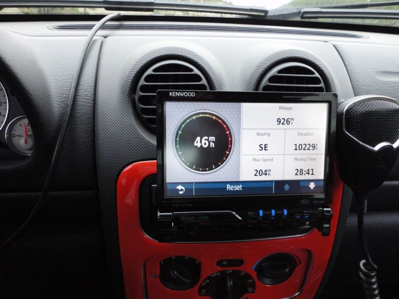

Posts: 8,393
Originally Posted by marlon_jbt View Post
GPS isn't 100% accurate all the time. .
I can vouch for that comment.
Notice the max speed? And yes that is in miles per hour.
'02 Liberty sitting on 35" tires,HP44,RockJock60,and AtlasII t-case
tjkj2002 is offline
