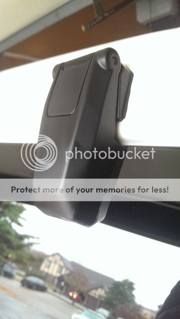

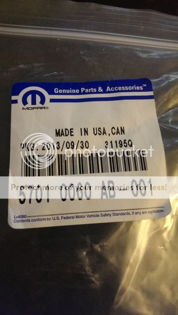

I know this is an old thread, but it recently helped me with my hinge. Ours broke while on vacation, so I glued the hinge back on and taped around the window. I tried insurance, but they did not want to do anything since the glass was not broken. I called my local dealer with the part number listed above and they got for me next day at a cost of $40. There are different part numbers for the left and right, mine was the passanger side. Thanks for posting the part number, if I had not seen that I probably would have replaced the whole window since I was originally told the hinges only come with the window. Here are a couple pics.

There is a small hole in the glass for the bolt to go though. I did not take a picture of the window without the hinge attached, but I did take a picture of the new hinge before I installed it. The new hinge came with a new bolt to go through the window. My window was fine once I got the old bolt out.

I did it myself, only took a few minutes, it is only 2 bolts. Hardest part was getting the bolt out of the glass. I took my time and was careful so I didnt damage the glass.
