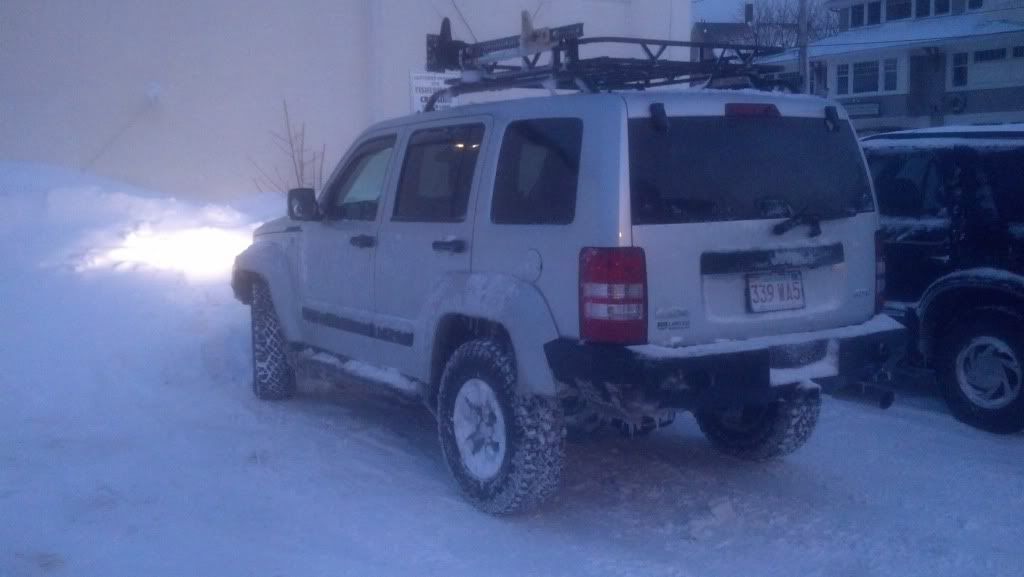

4 hi in the snow(deep) sucks the brakes keep kicking on, put it in 4lo and it just goes thru it like nothing at all, Hey Jeep your doing to Jeep what the liberals are doing to this ****ry(yeah I spelled it right). JMO[IMG][/IMG]

anyone know what the black box under the bumper below the gas fill is??
Richie from Boston
27tubguy is offline
post #11 of 20 Old 02-11-2013, 07:14 AM
AtTheHelm
Join Date: Nov 2012
Location: South Lake Tahoe
Posts: 860
Fuel evaporative canister. Basically a box filled with charcoal with sensors plugged into it.
