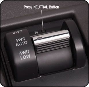

This is what I have this is why I asked the question should I worry? 2WD 4WD lock 4WLOW

Honestly your probably ok, yes you have Command Trac. And you should try not to use 4W anything on dry pavement, but that does not mean if you drive it once that way its toast or anything. You will see a few that say they have seen it, but I never have and you do not see much talk about somebody screwing up their system by doing this on the web. Test it out, just see if it will shift into 4Hi and 4Lo, you can hear it engage, roll it a dozen feet in a straight line and see if it sounds like obvious grinding or clanking. If not, Id bet your fine and tell the old lady no touchy that little switch.

Thanx Ranger I think I'm fine too. I went into a snow cover field and put the 4x4 system through the test nothing seems to be wrong I'm going to bring it to get the tranny rear and 4x4 fluids changed in June so if there is a problem I'll find out then. As far as the wife she usually pretty good she just forgot about it. So I'm going to forget to take out the garbage for a week.
