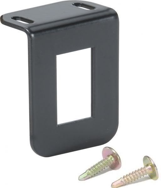

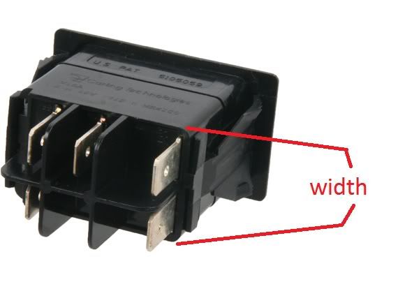

Do you have the measurements for what size holes you had to cut for the switches?
I'm afraid I didn't bother to write them down.
I had purchased a three switch mounting plate which I wound up not installing, and used that as a template for the height similar to this:
for the width I just measured from the narrow end on the actual switch (I think it was 15/32 of an inch but I don't remember for sure):
There was some filing involved to get it right, but it's better to cut smaller to begin with since you can't make the opening smaller once you cut!
If I did this again, I would spend the extra 5 bucks to buy a single switch mount to use as a template like this:
