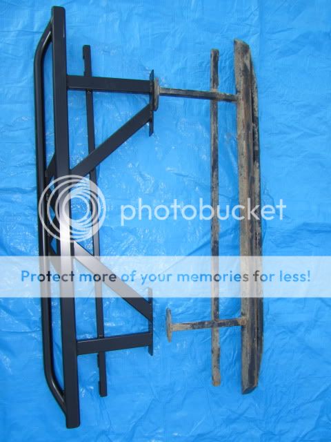

Sorry their stuff is far from bombproof. Don't mean to put you down or anything but their sliders are a joke.
Guess which one is made by rro.

Rocky Road just copies what everyone else makes, ONLY difference is they make it much cheaper and prone to fail no matter what it is
You only deal with them once if you're smart

hopefully, I wil have better luck with my new front bumper.

Have someone double up or reinforce those 1x1 support legs and you might be ok. Show the welder the pic of the bent part.
