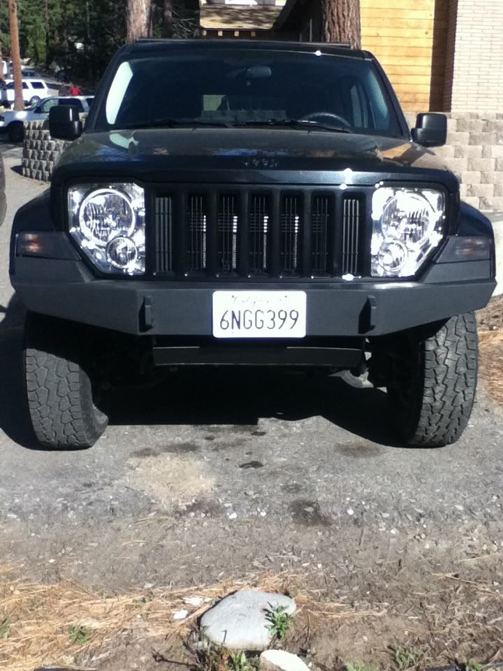

Here ya go
This is my prototype bumper that is on my Jeep now, which is a little different than the one i have templated for production.
Custom skid

post #11 of 35 Old 12-02-2012, 06:39 AM
jonrjen
2011 KK Liberty
Location: Texas
Posts: 1,077
Looks great as a matched set. ya done good my friend !!!!

post #12 of 35 Old 12-02-2012, 11:34 AM
Wearyman
2008 KK Liberty
Location: Buffalo
Posts: 142
Very nice!
I notice that both your front and rear bumpers are shorter (narrower) than the stock bumpers, particularly towards the outer edges. Was this for a specific reason or just to your taste?

post #13 of 35 Old 12-02-2012, 12:06 PM
jonrjen
2011 KK Liberty
Location: Texas
Posts: 1,077
I would venture a guess to improve approach and departure angle allowing larger obsticles to be overcome if approached properly.
