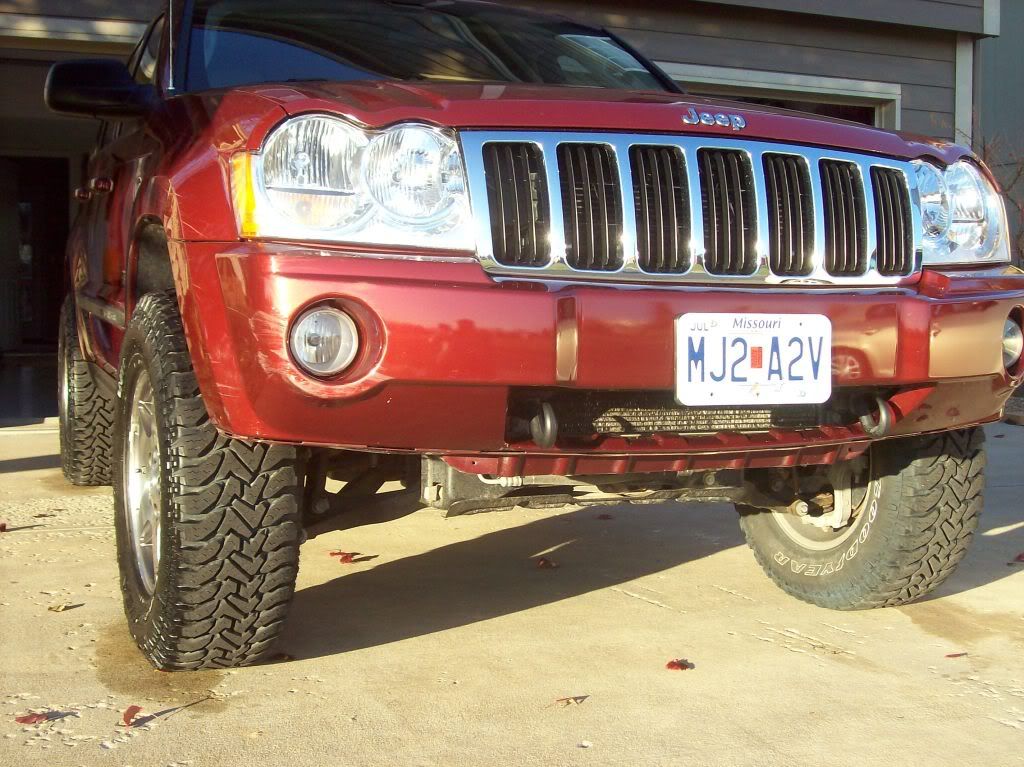

Musclez - the KK airdam is so thin it doesn't make much sense why they even have one. I know what you mean about the exposure. I think yours looks good either way. It's a different rig, but I took the airdam off the WK after lifting it. It is a more substantial piece and would probably get anhihilated when wheelin. I like it better without it. I definately want a front skid plate, though . . .
Yes you are correct... and DAMN that air damn is HUGE ! lol
