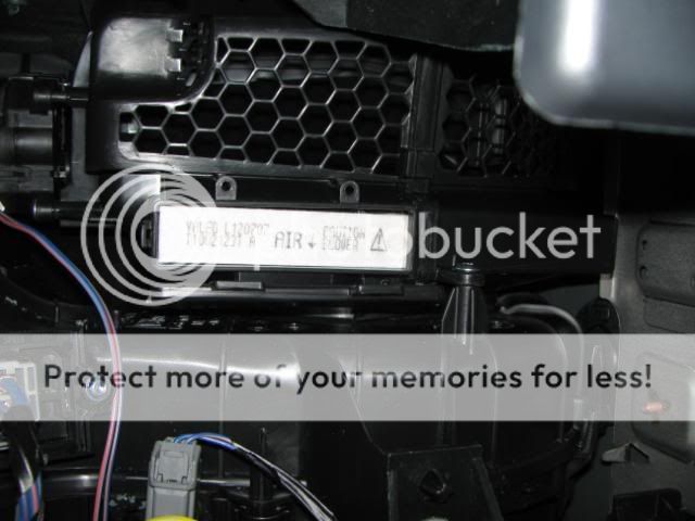

Declip the glove box so it swings down all the way to the floor of the passenger side foot well.
If you see something like this back behind it, then you've got the "cabin air filtration" feature on your KK:
If so, then behind the compartment on the left permits access to remove and replace each of the 2 filters:

Ok my next question, is where can I buy one from... I finally found the filter on my 2008 limited , and it is PACKED with dirt...

Ok yall. I finally found the second filter, and OMG it was filthy.... 3 and a half years in there they were plugged...
