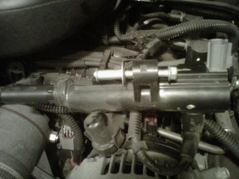

I posted this on another thread as well, but figured since I mentioned it in this one I should put the pic here too.
This is the 10mm bolt that holds the coil pack down. It loosens but feels like you can't pull it out. Like I said, pull straight up with some force and it will pop free. The collar you see in the pic is crimped on the bolt and won't come off. The little flange on the bottom is what keeps it from coming off until you pull on it.
