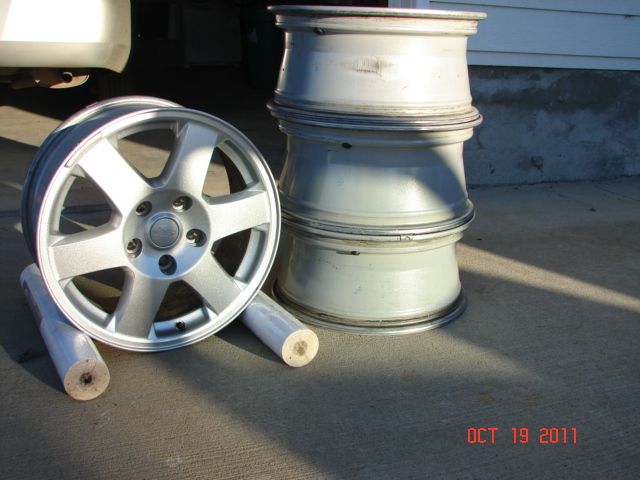

Hello from the WK forum!
I placed an ad on CL selling my Sextant 17x7.5's wheels (Bolt Pattern: 5x5 or 5x127mm Offset: 50.8mm Back Spacing: 6.25inches) and I had an interested party inquiring about them and if they will fit on an 07 KJ?
I really didn't have an answer from him other than I listed the wheel specs for you to do your own homework but now I'm wondering. Anybody have any specs for your stock wheels or have any experience with wheel swapping between models?
Thanks for any info!

I'm pretty sure the KJ bolt pattern is 5x4.5 on 16" rims stock.. but thats all I know haha im sure someone here has a much better idea

Won't fir different bolt pattern and also lots more backspacing

Thanks, that's all I needed to know.

Will need a lift to be able to use adapters.
