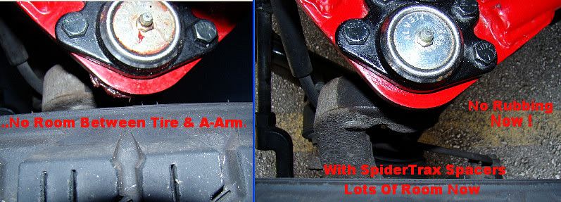

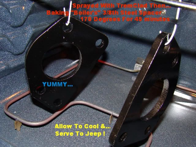

In my situation I used Boiler's 3/8 steel Top Plate. New at 22.75 inches hub to flare.
I also used clevis lift 3 conduits to driver's side & two to passenger as driver side seems to settle lower.
Now level. OME 927-948's also & Bilstien Shocks. TeraFlex bump stop & hockey pucks rear.
I ended having to use JBA 4.5 A-Arms as the top plate and clevis made the springs hit the stock A-Arm.
Also Spidertrax 5x4.5x1.25 got utilized to git rid of some tire rubbing and give clearance from inner fender well.
The difference from the bagged suspension where I could barely get 3 fingers wide between tire and fender to where you can now stack the tall coffee on top of tire is sweet.
It rides better than new to say the least now.
I will let other's comment on true 31" tires though, they may still rub without pinch weld pounding... in turns.
