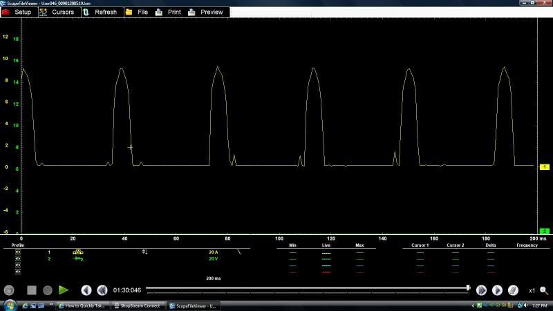

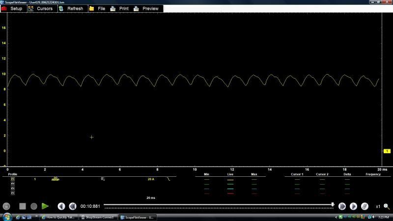

post #26 of 30 Old 04-25-2012, 08:37 PM
streetglideok
2005 KJ Liberty
Location: Castle Pines
Posts: 3,266
This is a good fuel pump. Nice series of bumps, which is measured in amps, and reflects the actual minute changes in current as the motor turns.
The rest are different fuel pumps that were bad. The last one wouldnt even make enough pressure to start the car. The second and third from the top, you can see unevenness in the ripple, especially the second one, showing a spot on the arm of the motor shorted causing a brief current spike. The fourth one down has a blatant dead spot, and this is the pattern you see on a fuel pump that may work after you have tapped on the fuel tank to jar the motor off the dead spot.
