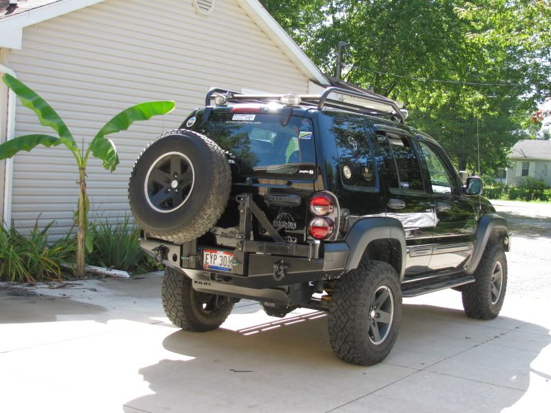

mine
since Bob threw up a front view I'll give you mine in a rear view LOL
