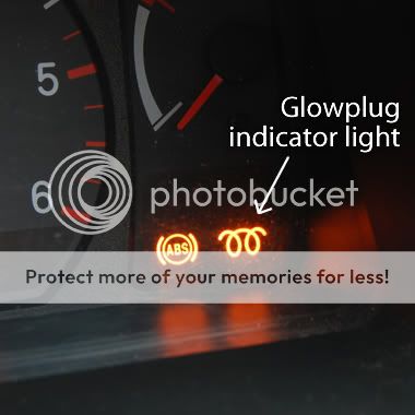

What does the "curly coil light" look like?
Cause i dont see any lights that fit that description. I'll get a picture of my dash when i put they key to run.
CodyJ5 is offline
post #14 of 28 Old 08-27-2011, 01:40 PM
JeepinJarhead03
Location: Chapel Hill / New Bern NC
Posts: 304
from a dodge nitro but indicator should be identical

I dont have that indicator. Heres what my dash looks like when i put the key to run.
