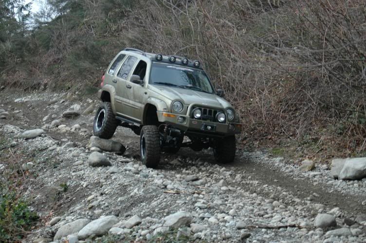

My 02 Jeep Liberty Renegade!!:)
ARB Air Lockers front and rear, Dana 44s front and rear, ARB Deluxe Bull Bar Bumper, Custom-created Frankenlift, 3-link setup, Bilstein coilovers and shocks front and rear, warn winch with green synthetic winch line, boulder bar rocker guards, currie antirock sway bars!

Looks like ARB Seths old ride is still around,
thought it went to Alaska ?
Built by AllJs, www.boulderbars.com
LOTS of photos of it on LOSTJEEPS
Oh and by the way I have the Yukon rear axles in mine now, that was in that at one time before the final SFA
So you swapped in a D44 front in place of the bent HP30 that was in there when sold?

Yeah, the guy who had it before me changed it from how Seth made it! I am trying to get ahold of this Seth guy being that he lives in WA, as i do too! I'd like to ask him some questions about Mean Green!
