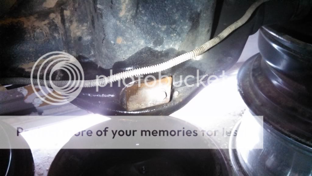

Here are the holes above the yoke. Sorry its not the best picture

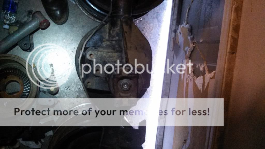

And here is the speedo housing on to of the axle:

Well jamesdart... I gotta hand it to you. You were dead on! Its a Detroit Electrac locker. Visually it looks similar to the ox locker, but is slightly different in function. Im going to see if I can order the final parts necessary to make it functional. If not, I managed to snag a used OX cover, cable, and shifter, with fork for dirt cheap. Im thinking I may try to adapt the manual shifter to my locker since I would really prefer not to have the electronic solenoid. Unfortunately the shifter location of the ox cover is about a half inch off. I could possibly have it milled out to accept the Detroit Electrac Fork
