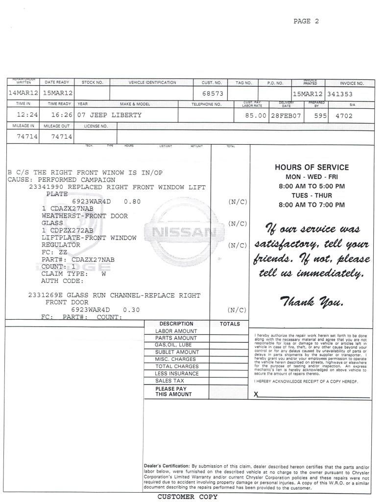

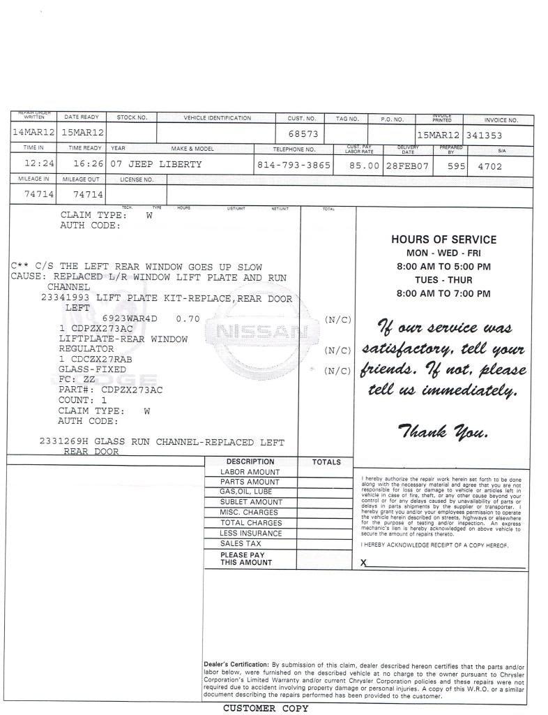

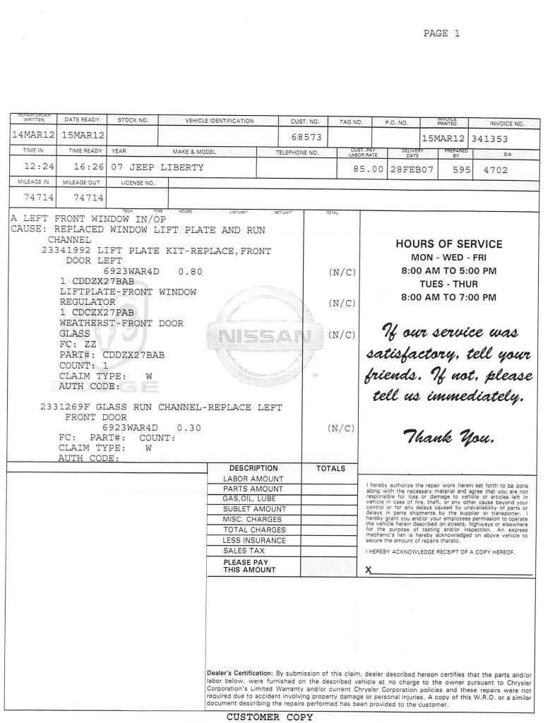

I've had two of the four regulators/stuff replaced at different times. Last week back to the shop to replace a failed number three.
In my visit for the third... The Jeep service folks reported there was a "new" replacement repair kit for the problem. This superseded 23-026-10.
As a result... They replace all four regulators/stuff with the "new" repair kits.

The mystery continues... Here is a copy of my paper-work:
