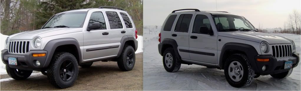

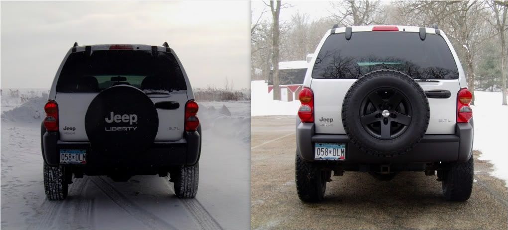

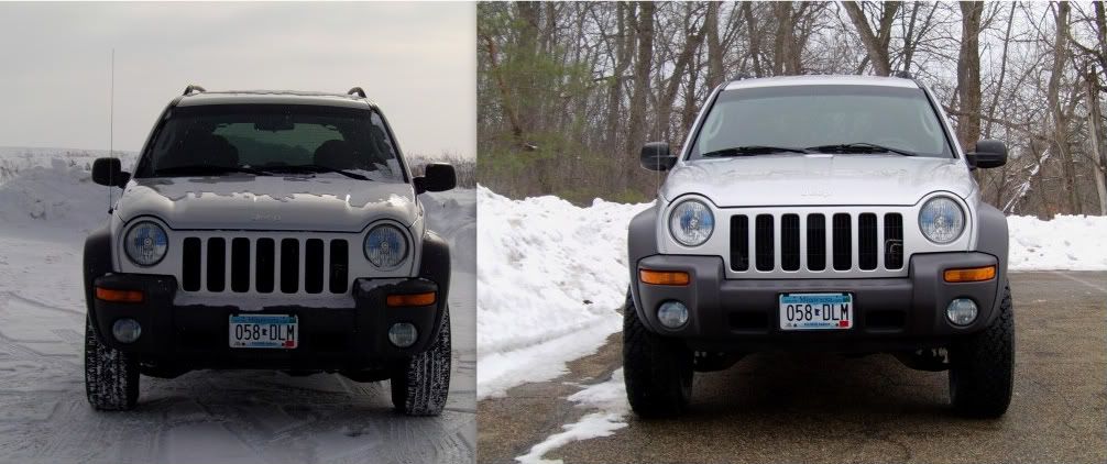

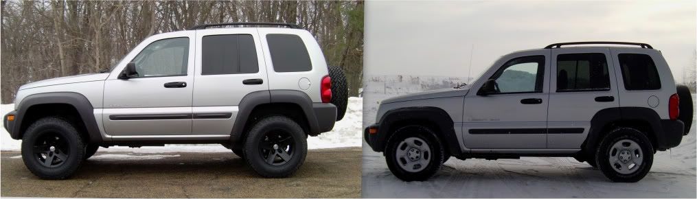

Before and After pics!
Before and After
03 Jeep Liberty - 2.5" Daystar lift
255/70R16 General Grabber tires

Before the install I was at 18.5" from the center of the wheel to the fender flare. Now Im at 21.5" between center of the wheel and the flare. Im not sure how I got 3" out of a 2.5" lift but Im not going to complain about it. ;-)

I got the lift kit at AutoPartsDealer.com for $135 lol I was bouncing around for awhile on what lift to get but I seen bad reviews on basically every lift I looked at. So I went with the spacer lift and put new shocks and struts in. Hope this helps
So now you are 2 inch above stock, which is 19.25-19.50 So you didn't get 3 inches of lift really, well you did from your sagged out springs
Tom,
But he didn't replace the springs, did he? I gathered only the spacer lift was installed, using the factory coils.

How many miles do you have on the stock springs? That looks like a lot of lift for a 2.5" spacer set up (I have the same Daystar lift). It seems like you have ZERO to very little sag which would be rare for a 2003.
I have a 2004 with 82k and the Daystar spacers, and it has dropped about half an inch or so. Rear shocks are Ranchos (for a Durango/Dakota) and the front are stock (which will be replaced soon).
