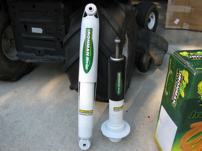

Marlin sent me the kit last week for testing
I'll be installing it next week for testing and will do writeups etc on how it does compared to the OME springs
Just for some back info I have ran OME 927s for 100,000 miles and currently have OME 790s on the front of mine for over 50,000 miles now
I have also had over 20 KJs that have went through my garage and received OME 927s etc so have a pretty good idea of how they ride with various shocks
I'll post up as soon as its installed
Oh and they have trim packers which you can get as well, ( 5 and 10 mm available ) I'll be running a 10 mm trim packer along with a 1/4 inch top plate
Now something else you may want to look at is the fact that the rear shocks are the same length as stock

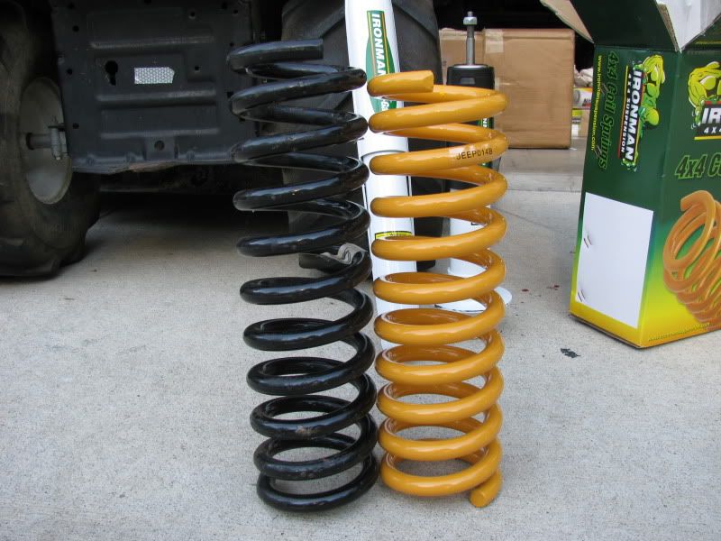

OME 927 compared to the Ironman in height, yes I keep extra's sitting around for S&Gs

the springs look thicker, or is it just the color throwing it off? i was looking at there stuff a while ago and they seemed like they bite off arb a lot, or just rebadge some stuff. is the kj lift new from them? i was talking to one of thier guys last year at a show and they told me they had nothing for the kj for lifts.

The front springs are thicker for sure, noticeable difference.
I know they just started shipping at least the KJ/KK springs into the US. Marlin had contacted me before Easter Jeep Safari about them and just got them in last week, so slow boat over
The powder coating on the springs seems thicker and a higher quality than whats on the OMEs
