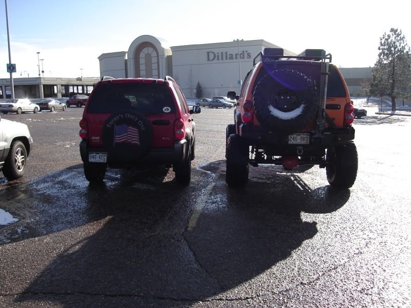

For a quick reference
mine on the left has 265-75-16s
one on the right belongs to my friend Chris has 245-75-16s
tommudd is offline

Originally Posted by tommudd View Post
245-75-16s just a lift and enjoy
If say you want to go to 265-75-16s then you have to go to 4.10 gear front and rear, possibly do more cutting of the fender wells , etc . You could easily spend another 1500 or so real quick.
Or spend a few $thousand$ more and go big,like 35".

Both look nice!! what else did you change? arms? etc
