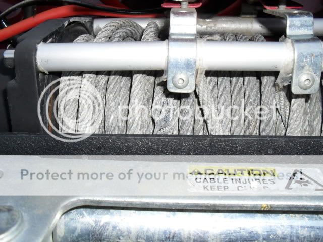

Originally Posted by 1398653 View Post
here r s couple of pics. What do u guys think?
That rope is no longer safe to use. Get your replacement wire rope from Recovery Gear
Edit: Well, that website has been updated so it doesn't seem to show their specific wire rope products and pricing any more. They were the cheapest around but you'll probably have to call or email them to get an actual price now. I bought two wire rope replacements from them and their prices were better than any other source I've ever found.
But if you have the $$$, I recommend going with a 3/8" synthetic rope like from Viking instead. It costs more initially but it will outlast wire rope if you don't drag it over sharp rocks. I went through three wire ropes in 3-4 years but managed to keep my 3/8" synthetic rope for five years before my TJ that had that winch and rope was stolen earlier this year. Plus synthetic rope is much easier to use and is far safer. I STRONGLY recommend 3/8" over 5/16" when switching to synthetic to provide a bigger safety margin if you have to use it where there are could be sharp edges it might have to be dragged over.

I considered a synthetic when I bought mine, worth the money on the safety factor alone, IMO. But I use my winch a lot more for work around my farm/hunting/fishing property a LOT more than getting my truck unstuck and thought that kinda use would be a sure ticket in fraying the heck out of the thing and basically wasting the money I could use to buy three steel cables.
Now if/when I have to replace the one on my M8000 that's reserved for my GC, I'll prolly go that route. It's pretty much gonna be an emergency use winch and the weight savings would also be a much bigger factor on the front of a GC as opposed to the one on the front of my 7000 lb. truck...

I would love to get synthetic but I cannot afford the 300 bucks it would cost me to switch over. In the future I am going to switch but I an saving for a regear, a rear bumper and tire carrier and Tom Woods drive shaft so I really have to watch my money.

Ok, now I am thinking of just going ahead and getting synthetic. I am kind of sick of trying to correctly spool the steel cable. I kind of suck at it. Is the synthetic significantly easier to work with and spool up properly after use?

Thanks for the advice Jerry, After reading this I decided to go with Viking 3/8 x 80 feet synthetic line. I ordered it with the line protector and I decided to go with the safety thimble. My winch line is officially worth more than my winch (smittybuilt xrc8)
Now from your previous posts I learned that u can use the regular style fairlead as long as it doesnt have burrs on it right?
Man it was hard to push the order button 300 bucks, but I am really sick of the steel cable, it has given me nothing but trouble. It wound up like crap. I am hoping I have a lot less troubles with synthetic. Hopefully it outlast my winch and I will be transferring it over to a new winch. Again, thanks for the advice everyone.

Now from your previous posts I learned that u can use the regular style fairlead as long as it doesnt have burrs on it right?.
Yep, just file or grind it smooth. The early rumors that you needed a hawse and couldn't use a roller fairlead with synthetic rope proved baseless.
Enjoy that new synthetic rope and Safety Thimble which was developed by our very own mrblaine. I wish I could afford another synthetic rope and Safety Thimble to install on my replacement winch but that'll have to wait for a while longer.
