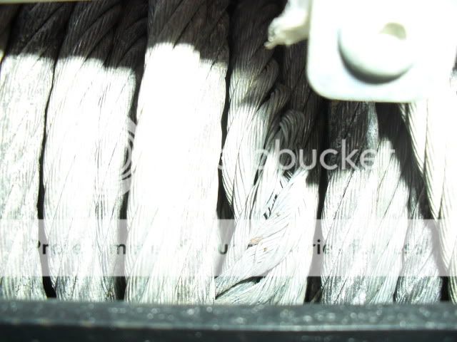

here r s couple of pics. What do u guys think?

Replace it as soon as you can. That is now the weak link. Very dangerous. Looks like you never re-spooled it after use.

Hey Steve, did you unspool it?
I think a good look see is in order.

I havent had a chance to respoll it properly. The last time I had to use it was friday night and it was a night run so it was hard to see. I am not sure if that is when I damaged it, I got hung up back on a downed tree in the trail, it was kind of big but there was no way around and we had no chain saw. So u think that is damaged to the point it needs to be replaced? I thought i might be ok because it isnt frayed. Should I respoll under some tension and see what it looks like afterward?

Any of the following listed conditions should be cause for rope replacement.
* In running ropes, six randomly distributed broken wires in one rope lay, or three broken wires in one strand in one rope lay.
* In pendants or standing ropes, evidence of more than one broken wire in one rope lay.
* Abrasion, scrubbing or peening causing loss of more than 1/3 the original diameter of the individual wires.
* Evidence of rope deterioration from corrosion.
* Severe kinking, severe crushing, or other damage resulting in distortion of the rope structure.
* Evidence of any heat damage resulting from a torch or arc caused by contact with electrical wires.
* Reduction from nominal diameter of more than 1/32" for diameters up to and including 3/4". Marked reduction in diameter indicates deterioration of the core resulting in lack of proper support for the load carrying strands. Excessive rope stretch or elongation may also be an indication of internal deterioration.
* Evidence of "bird caging" or other distortion resulting in some members of the rope structure carrying more than others.
* Noticeable rusting or development of broken wires in the vicinity of attachments.
Those are standard wire rope replacement criteria. You've got a severe kink in there. Either shorten your cable or replace completely. You should be able to get a new replacement cheap from someone who changed over to synthetic.
