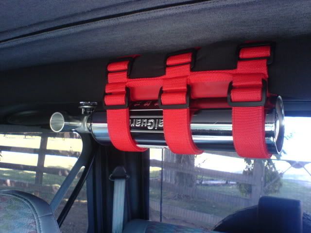

I have a Hal-Guard Halon fire Extinguisher. Look into the Halon for it does not leave any residue and excellent for electrical components.

Yep, Halon is not a good agent for a Jeep unless you know (which you cannot) you will only have electrical fires and never any gasoline or brush fires where you're wheeling. Good for a computer room but certainly not as a general purpose fire extinguisher for a Jeep.

Not arguing, Jerry, but my Halon says it's rated for ABC, although Wiki says only Halons over 5lbs. are so rated:
Halon (including Halon 1211 and Halon 1301), a gaseous agent that inhibits the chemical reaction of the fire. Classes B:C for lower weight fire extinguishers (2.3 kg ; 5 lbs or less) and A:B:C for heavier weights (4.1-7.7 kg ; 9-17 lbs). Banned from new production, except for military use, as of January 1, 1994 as its properties contribute to ozone depletion and long atmospheric lifetime, usually 400 years. Halon was completely banned in Europe resulting in stockpiles being sent to the United States for reuse. Although production has been banned, the reuse is still permitted. Halon 1301 and 1211 are being replaced with new halons which have no ozone depletion properties and low atmospheric lifetimes, but are less effective.
So, I don't know. I do like the idea of not having residue to clean up, but if it isn't going to be effective on all fires....

those of you with halon make sure if you ever have to use it that you are not in a closed in area. if you have a dash fire do not use it until you open all the doors. halon can and will kill you.

I went with the Halon extinguisher with the mindset that an electrical fire would be better suited for a mall crawler such as myself. I personally feel that my chances of an gas, oil, etc. fire would be limited to say an accident or possibly an F-up on my part. Now I'm not saying anything like this will never happen, there is always a possibility. I just feel my chances of anything catching fire would come from something electrical. However, Halon is also an excellent ABC extinguisher. One think that you guys brought up that never crossed my mind was other things around you catching fire(brush, trash, etc.) I guess I was more concerned about my Jeep at the time. Thanks for bringing that up.
Halon (ABC) - Halon extinguishers normally contain bromochlorodifluoromethane, a very heavy gas (much heavier than CO2). This not only displaces oxygen from around the fire but chemically reacts in a way that shuts down combustion. (It decomposes into chlorine and bromine radicals, which scavenge hydrogen radicals essential for keeping combustion going.) Halon extinguishers, like CO2 extinguishers, are especially suitable for Type C fires and delicate equipment, but because they chemically shut down combustion they are also good for Type A fires. They are being phased out because of the damage chlorofluorocarbons do to the ozone layer.

Halon is a oxygen displacer which means if there is heat or firesource the fire will come back, or if somone else is in the jeep your going to sufficate them. pluse depending on the age it is a hazzardous material in most states.
