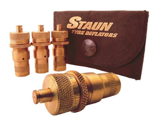

I use Staun deflators. Preset them for the desired psi. Screw them on, walk away then remove them when they stop deflating.
The ARB/Currie deflators although hands on, are by far the fastest way to airdown.

I used to have the Staun deflators. They worked great. You could screw them on and they would deflate to the preset psi even while driving. But...the problem with the Stauns is that they are not quickly adjustable. Say you preset the Stauns to 15 psi. But then you want to go down to 10 psi. I bought the Currie deflator so that I could air down to any psi and then gave away the Stauns.

I find the Staunch deflators to be inconsistent. The valves stick and don't deflate correctly.
