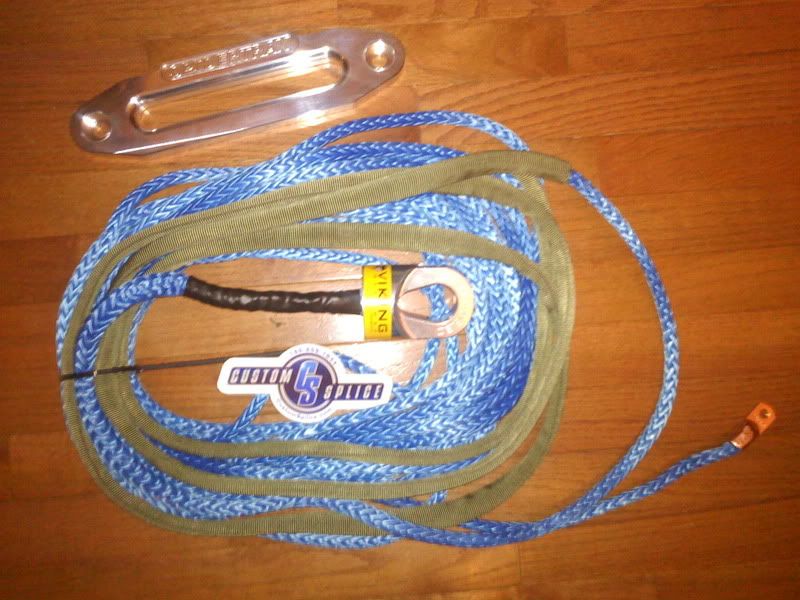

I'm extremely happy with my 3/8" Viking winch line. I just installed it last month and it's already been used 6-8 times, it is SO nice to be back on synthetic winch line again. I went orange this time, it's pretty bright.
Thor at Viking will be happy to install the Safety Thimble (developed by mrblaine) as you can see below. It's a great device for added safety, it prevents hands from being pulled through the hawse or fairlead.

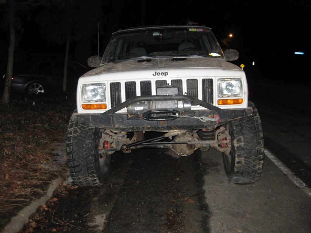

This one?
I'm getting a fancy aluminum hawse if I switch to synthetic line. Something like this probably

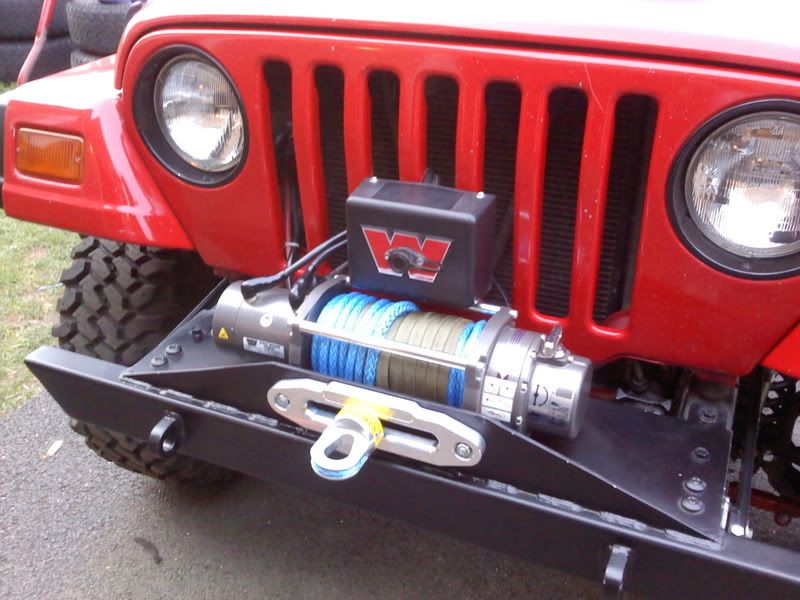

80' of 3/8" Amsteel Blue fits well on the M8000. You could run into some problems with the line bunching up if you go with 100'. There is always winch rope extensions if you need extra length in some situation.
Keep in mind, this is before I spooled the line on under load.
