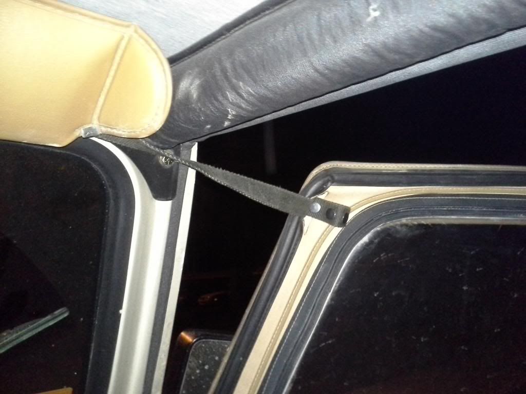

So, I have full soft doors and lately on the high way they have been flaping/ pulling out along the top letting in wind and lots of noise. Needless to say this has been driving me crazy, so I did something about it. Im not sure if hard half doors have this problem to but im sure this will work for them too.
Well first off here is the soft door.
here is what it does!!!!!

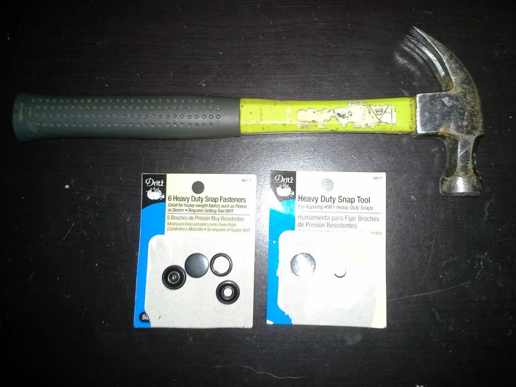

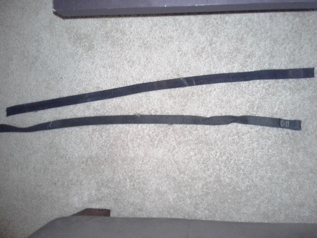

The things you'll need:
-heavy duty snap fasteners
-heavy duty snap tool
-hammer
-2 pull straps

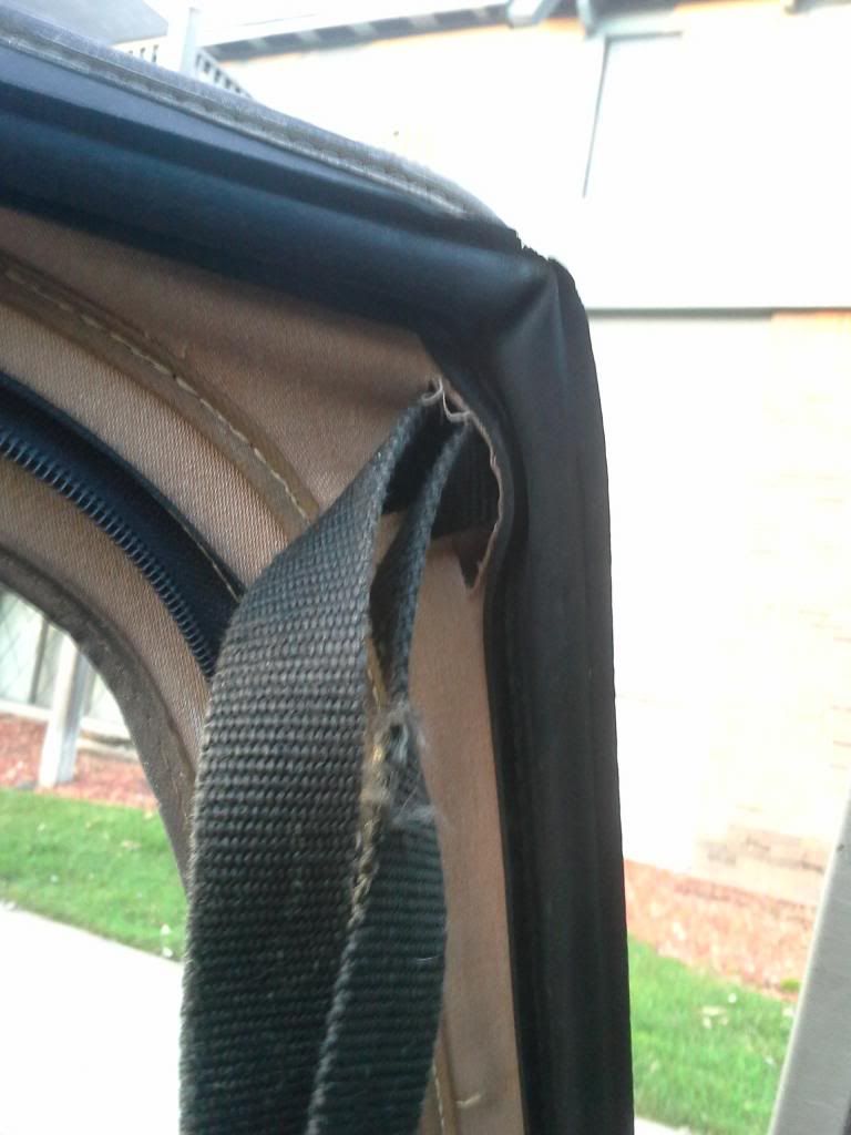

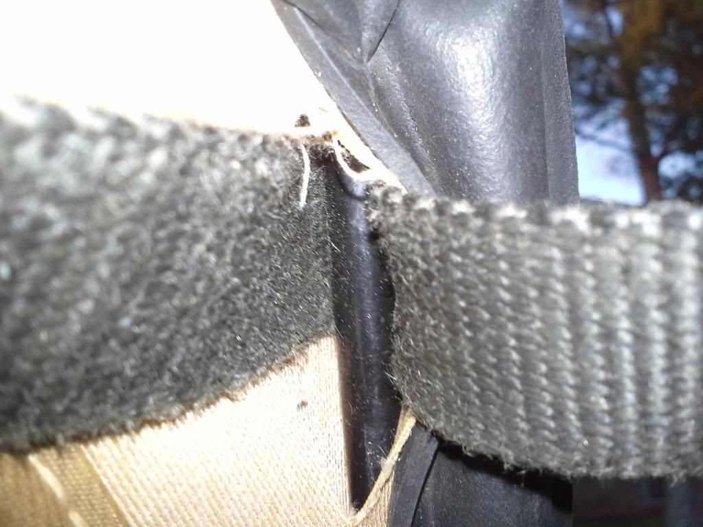

Firs thing you'll need to do is cut about a 2" slit in your soft uppers, scary I know. You must make the slit along the rod going down.

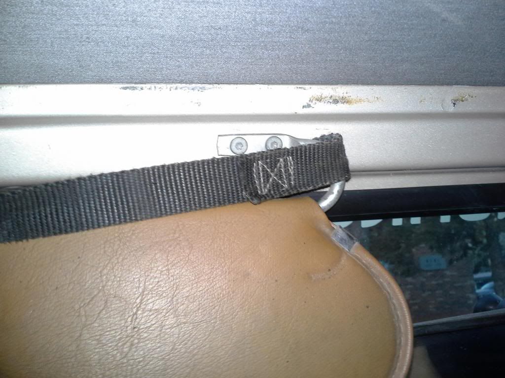

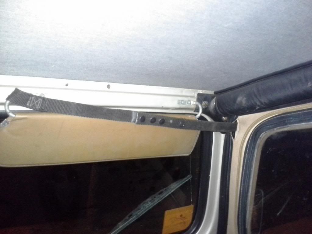

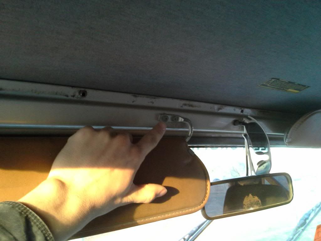

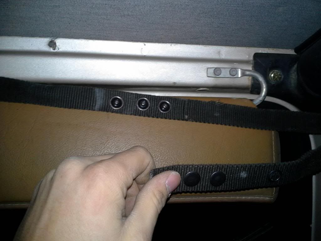

This is where you will need to loop the end of the strap. You need to remove the two screws.

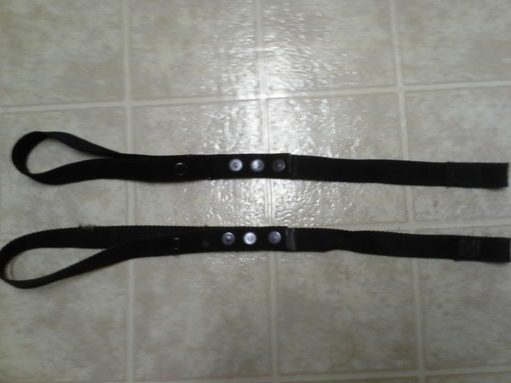

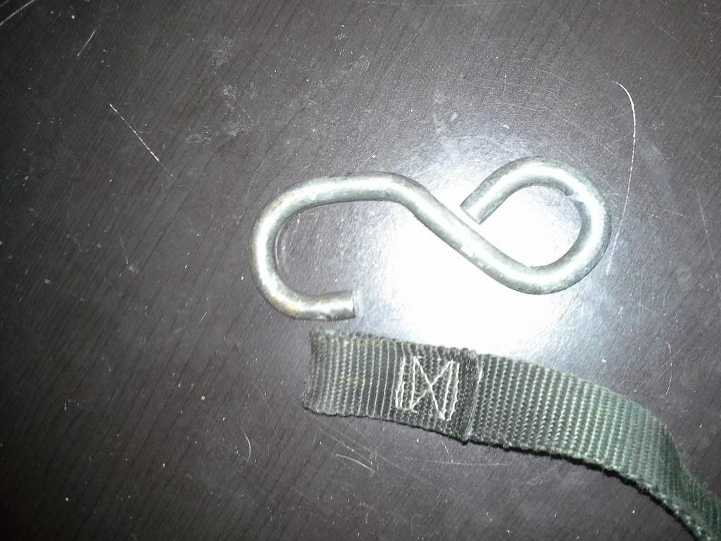

Next remove the hook from the end of the strap then cut down the straps longer then you know you'll need.
After you cut the straps burn the ends so the ends dont fray. Do this to the slit in the soft doors too.

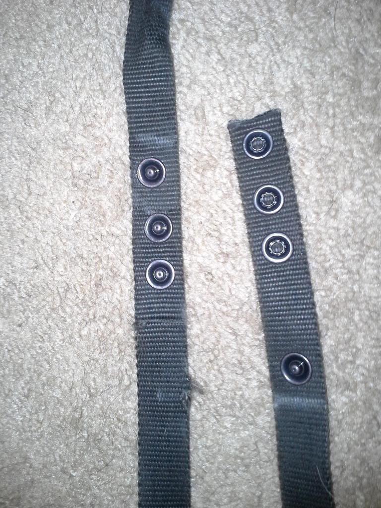

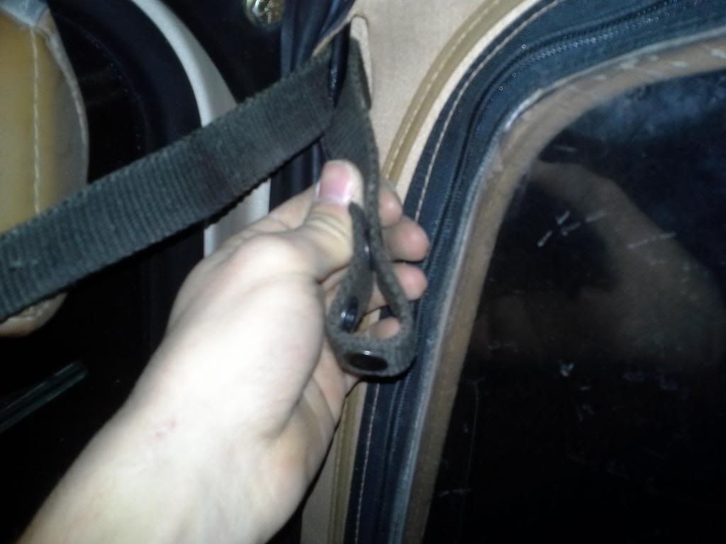

then take the strap and mount it on the visor bracket and the other end around the rod in the soft upper. Then mark where the buttons need to be. Note, putting the strap around the rod between the fabric is pretty difficult, doing it with the window unzipper makes it a little easier.
I marked for three buttons for extra strength.

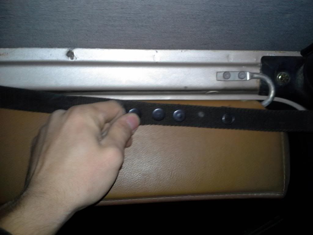

Remove the strap and fasten the buttons where you marked.
With just these three buttons it is very strong.

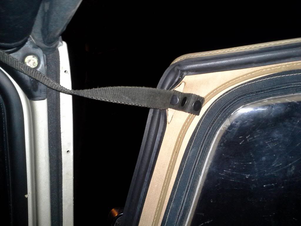

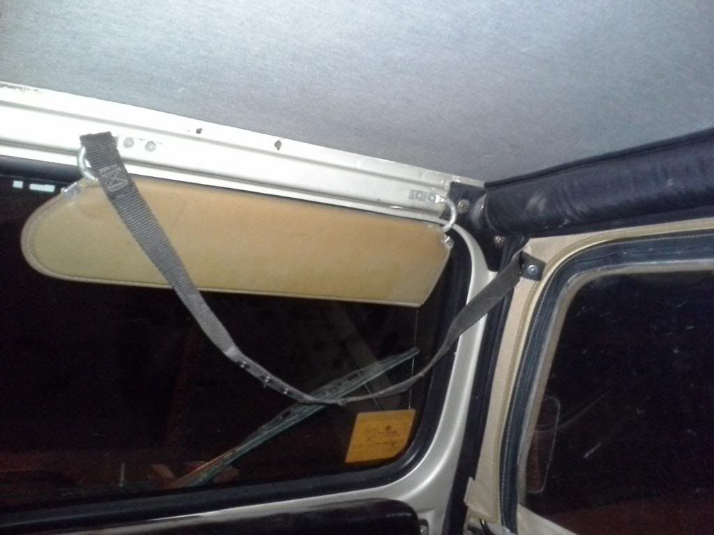

Then install the strap, heres what it looks like installed.

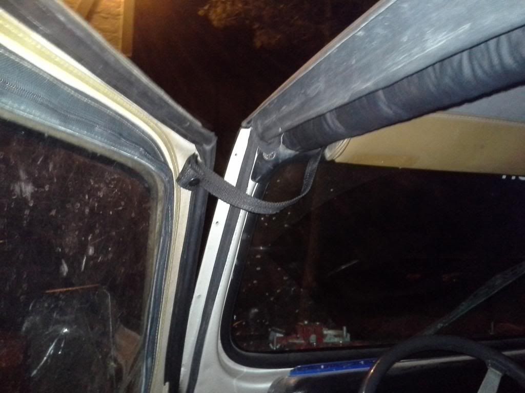

with the visor down, fully extended. I added an extra button to the end to make a loop so it wouldn't pull through, also acting as a very efficient door stop.

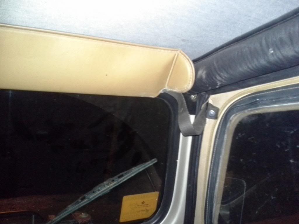

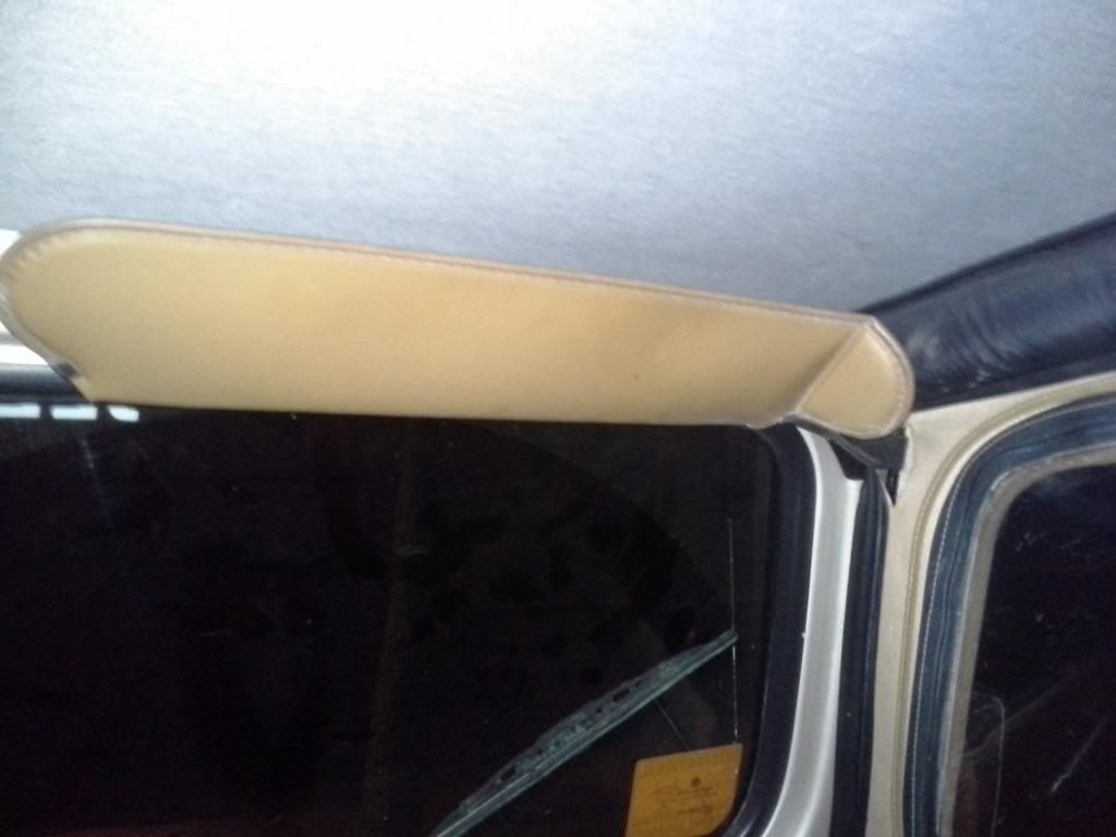

with the visor up fully extended
Then all three buttons fastened.
visor closed

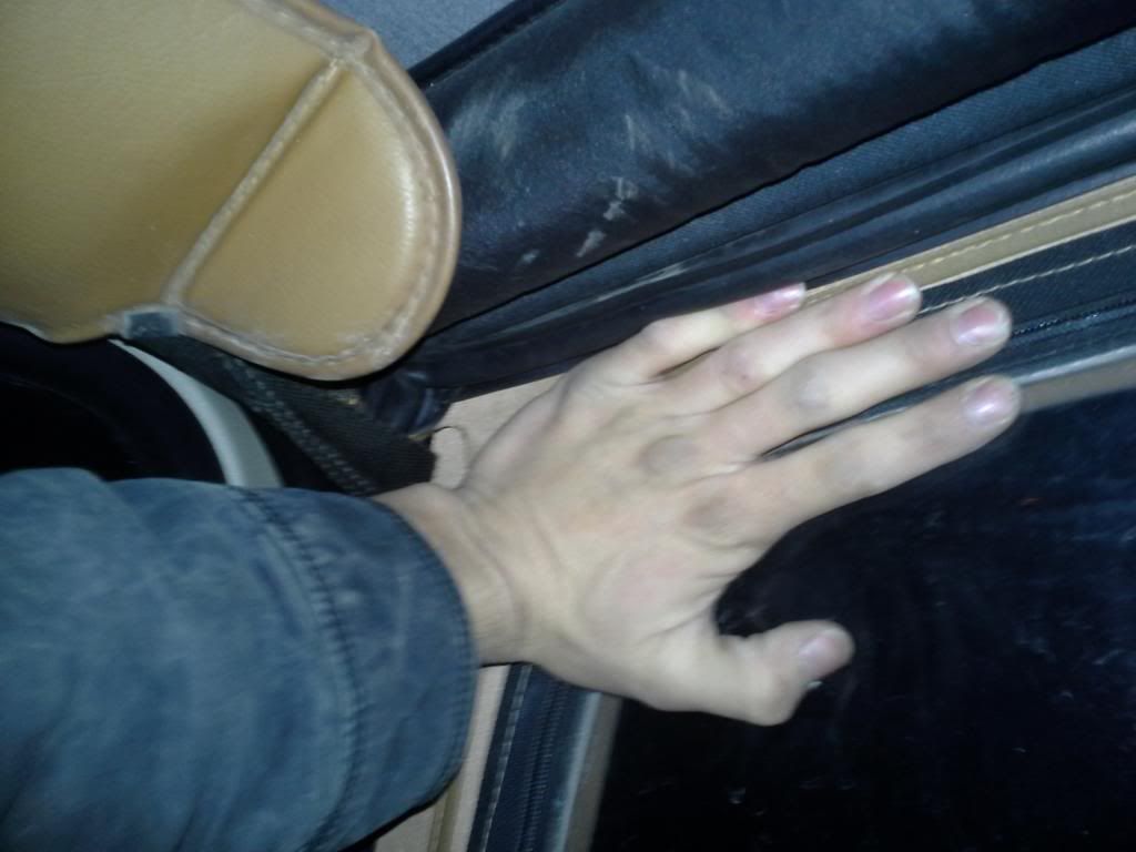

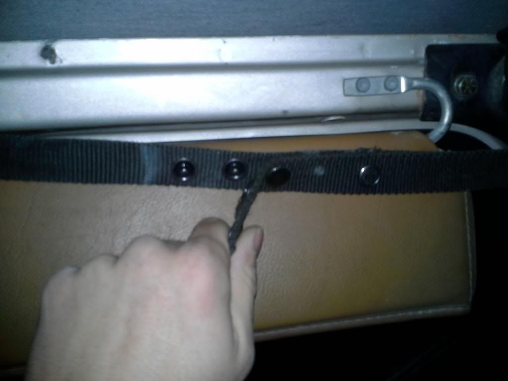

Works great, heres a picture of me pressing very hard on the top corner of the door and it doesnt budge.
The strap is still easily fastened and unfastened
ashland82391 is offline
