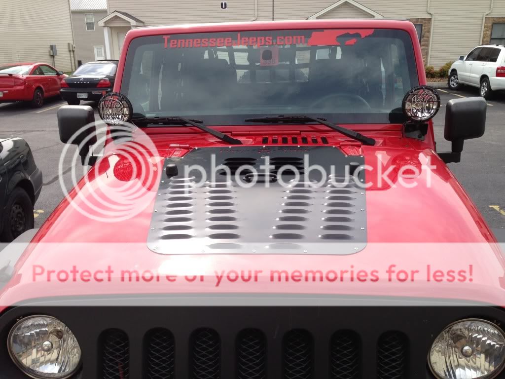

post #103 of 131 Old 08-10-2013, 09:39 PM
SmedzJK
Join Date: Jun 2013
Posts: 4
Finished the install yesterday. Overall, it was pretty easy. Not too impressed with the locking nuts, however (not very good quality). Instructions were easy too follow.

post #104 of 131 Old 08-18-2013, 09:17 AM Thread Starter
Carlos14
Location: Graham
Posts: 4,153
Looks good, I like the color matching you did with the grille
