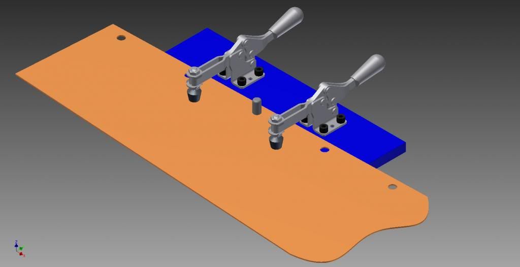

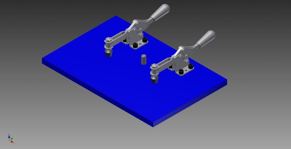

This is what i plan on doing to make sure there's no error on the holes:
I have all of the material needed for the tool already at work so a tooling cost isn't an issue. Once i get the hood louver, i would measure the hole and either find a dowel that fits, or use a larger one and turn it down to fit inside the hole. I would have the drill press centered to the dowel hole which would also be the exact center of the holes on the hood louver. To countersink it, i would clamp the louver down using the dowel to center the hole then remove the dowel and countersink it.
I would test the countersunk height by test drilling on a piece of 0.063 aluminum scrap until im happy with the height and set my drill press stop to that exact location.
It might be a little more work, but i think having it flush to the surface would look pretty sick

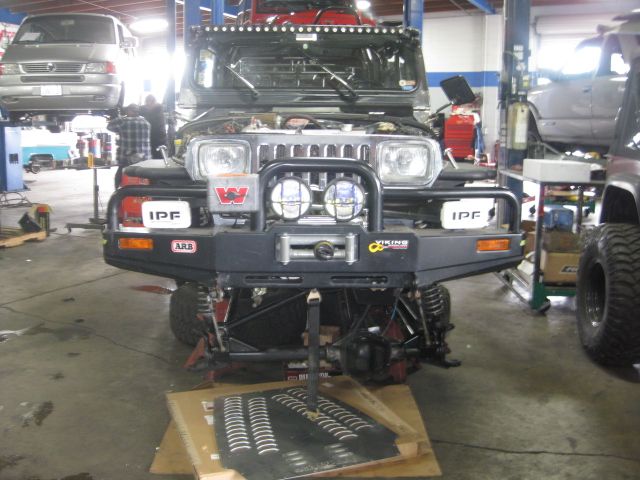

the hood looks really good. I am trying to decide if I should just polish mine to go with the black and chrome look or just paint it Hammer Finish Black like my rear fenders are currently. Some have suggested going with Red too but I think that would be too much red on my lil YJ. Thoughts???
Notice I didn't have the hood cut out the entire way on the passenger side because I am using a Turbo City Intake tube and KnN filter that is mounted across the valve cover and the filter sits near the rear pass side of the motor. I didn't want rain to go directly into the filter so I left that part of the hood intact.
here is a before shot:
but notice I have new wheels now... and that is why some say the Red louvers would look good. Or just polish it?
Here are some after shots:
Thanks for your ideas and feedback! Carlos yours came out SWEET!
