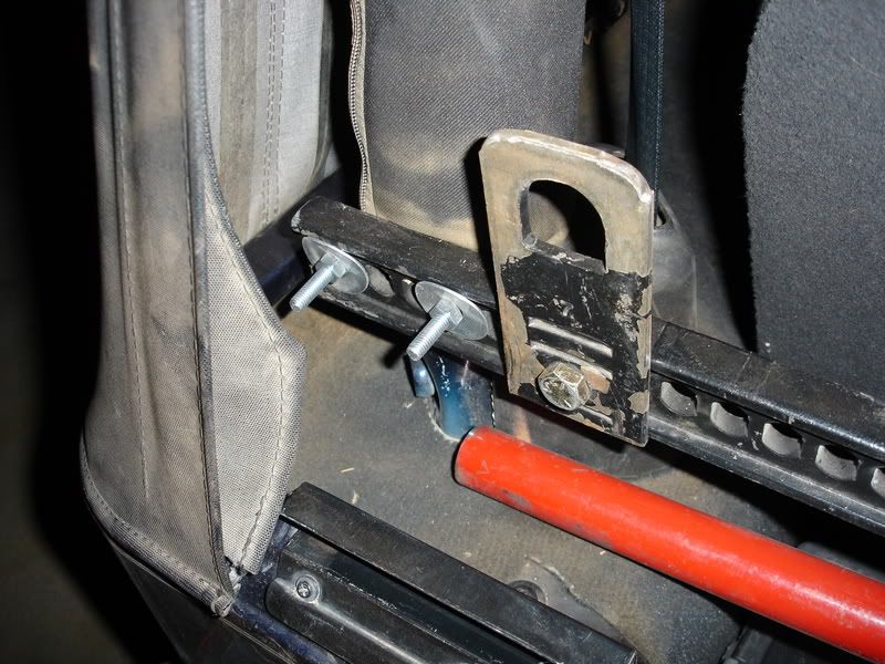

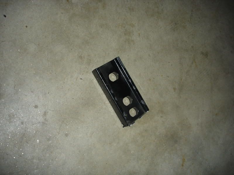

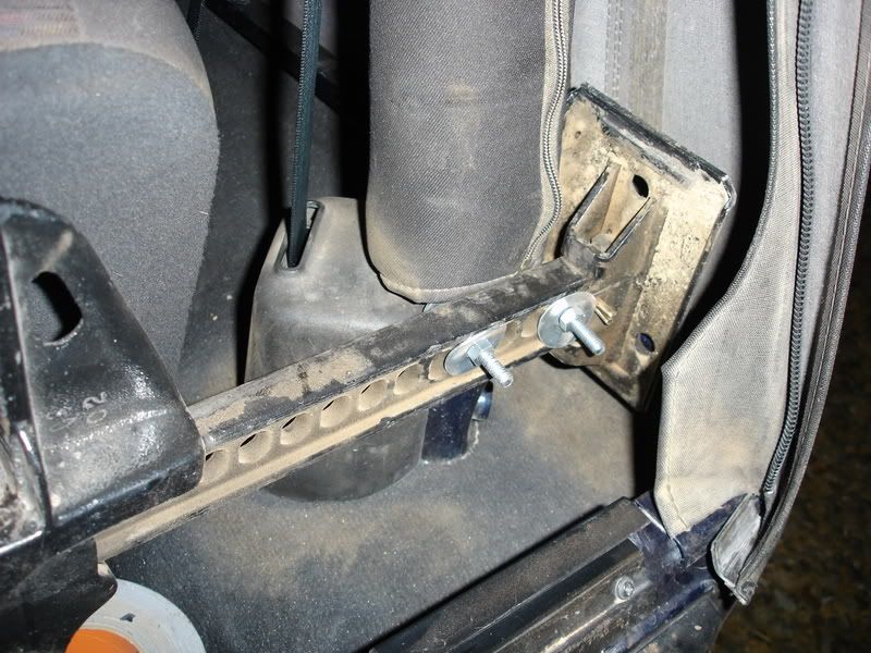

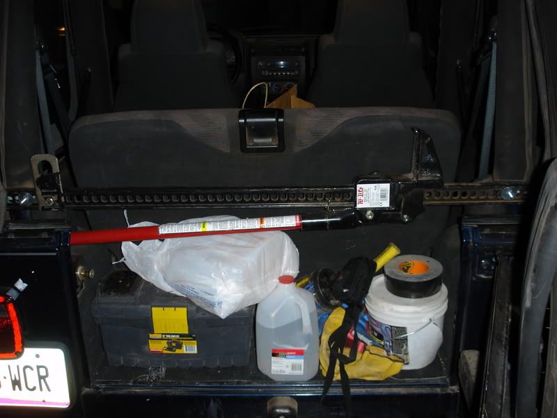

Here you go, sorry for the slowresponce, I was out of town this weekend.
There really isnt anything special about it. All you need to do is mount the U-bolt to the roll bar (make sure you mount it below the padding) with the supplied bolts and hardware, then use 2 more bolts and 2 washers per side to mount the jack to the U-bolts. This way when you remove the jack, the U-bolts stay in place. Also, when mounting the jack, you'll have to move the loop tab down on the jack and point it either up or down.

I take the base of mine off and bolt it with the wing nuts I have on the end of the jack. I replaced the cheesy pin they put in it with a bolt for easy installation when I need it.
