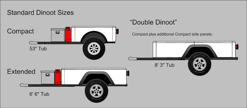

This one's a fiberglass tub kit that you can assemble on a Harbor Freight frame (www.dinoot.com):
And this military style trailer will be available in the next month or so, also as a fiberglass kit that can be assembled on an HF frame:

How much will the military style be? Will there be a kit available for the 8ft hf trailer? I'm about to buy(as in this weekend some time) a hf trailer, and I'm undecided on the small one or big one. I'd love to get the military style sides. It would save me alot of work
The military style kit is expected to be in the same ballpark as the Jeep-tub kit, might be slightly more but not too much. I don't think they've finalized the price yet.
Since it's a replica of the original M100/M416 trailers, the military kit is designed to be 6' long. There are plans for modifying an 8' HF trailer to fit the military trailer perfectly here: http://tventuring.com/trailerforum/t...8.html#pid2158 . Those plans also show how to strengthen the frame, and how to install receivers front and back (in the front for swapping couplers, in the back for things like bike racks, etc.).
The Jeep-tub trailer kit is available in multiple sizes, including an 8'3" version that fits very nicely on an 8' HF frame.
