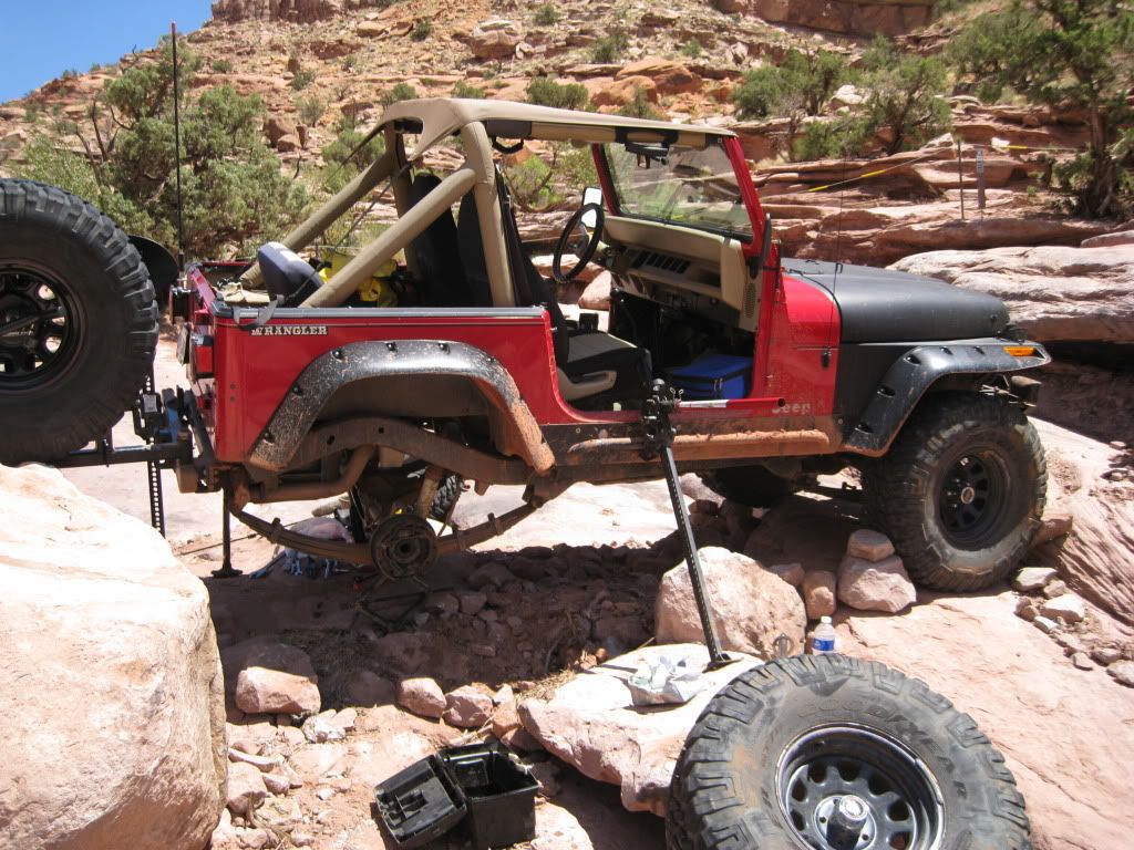

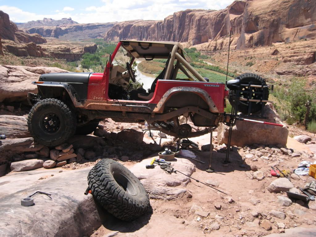

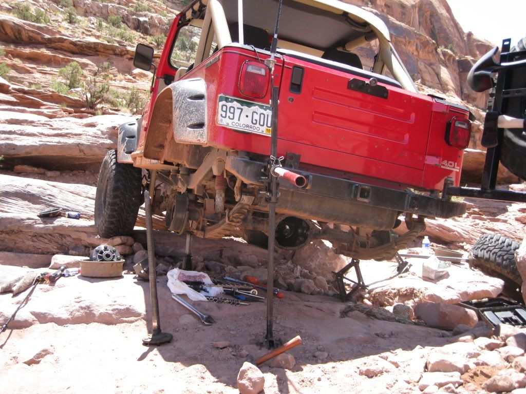

The Hi-Lift can be a great tool. Jacking, winching, stablizing, etc... My buddy was busted on Moab Rim last year. We had to rebuild his rear D35 right there. There was no other way to get out. We used two Hi-lifts, one bottle jack, and one scissor jack to stablize the Jeep the best we could and went to work.

wow that is scary

Scary to say the least. We wedged enough rock under the front end to stabilize it, used one HL to lift the rear, one to support laterally, and the bottle and scissor under the spring perches for redundancy. When things break, you are in a bad spot almost by definition. You must fix it to get it out or in places like Moab Rim...pay for a helicopter lift?
