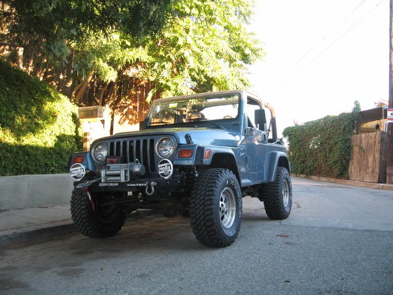

I'll give you an idea of how i did mine.
smartshot is offline
