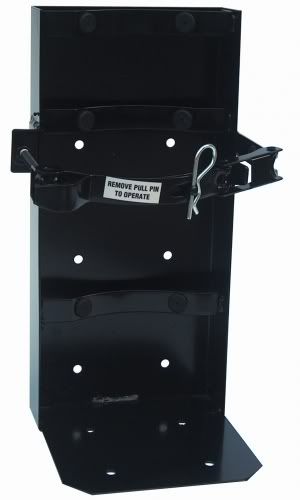

Oh ya and here's what a Heavy Duty Vehicle Bracket looks like. These will not break, not like the flimbsy ones that break when you take the extinguisher out. Plus you can put a lock on it when the tops off when your not around the Jeep.

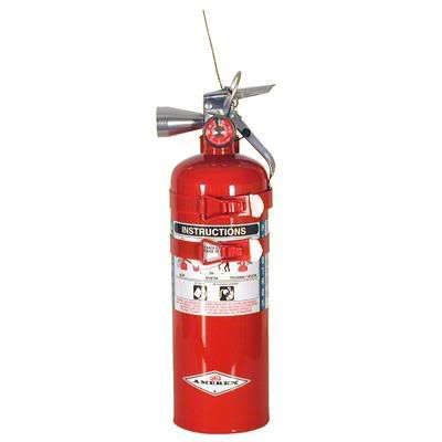

It depends on the manufacturer put this one is called Halotron. They don't come with a hose until 15lbs I believe. Here's a 5 or 7lb I can't remember. These are only BC rated also.

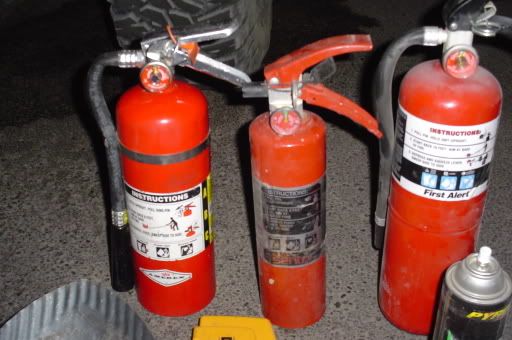

Here is what I carry:
