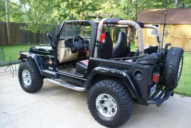

Originally Posted by 5artist5 View Post
Any chance I could get a picture of your setup Jerry?
Here ya go.

I like that location Jerry. I may try to go that way also.
