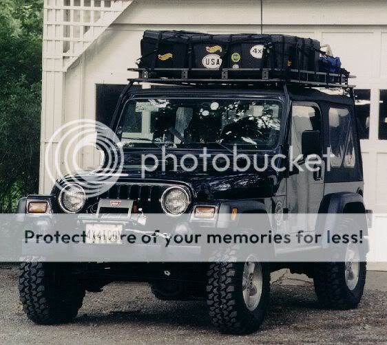

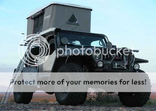

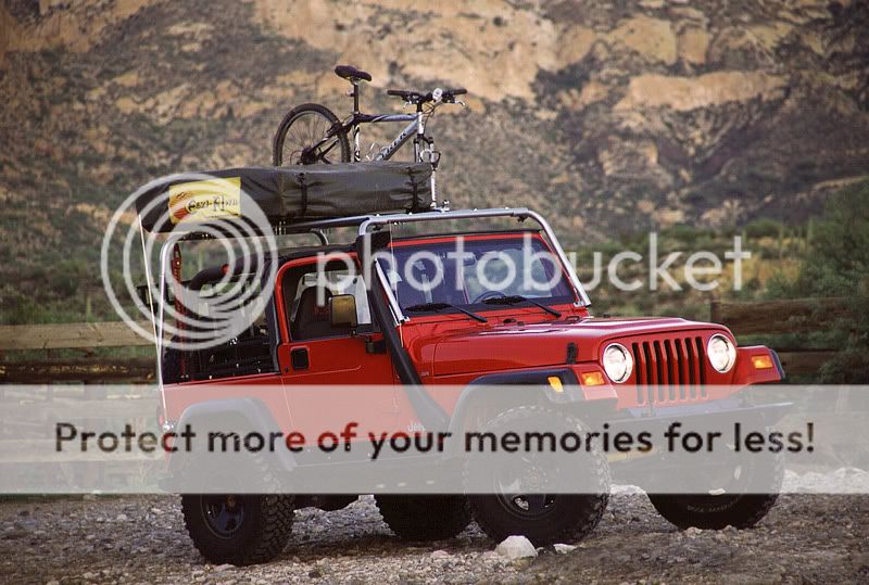

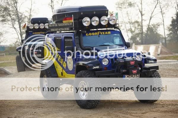

Here are some examples of some great Expo rigs....some are mild and some are over the top. Regardless they are good examples....
Notice in this photo the mild to no lift (could be good or could be bad depending on the owners decision on trips). There are some key items here (winch, secured overhead storage...not sure about the plate directly below the winch...but that is obviously in the way)
Here is a great Expo vehicle....done with attention to detail for sure.
I love this next rig...so many things to point out. You can see it for yourself....the tent is just amazing...would love to take a walk around this rig up close.
Now, we dont see the insides of these Jeeps. So they may be all show and no go. Whats on the inside counts just as much as the things you see on the outside. Yes, these are more hardcore Jeeps than most of us will ever own....but its a great tool to get a view of whats out there.

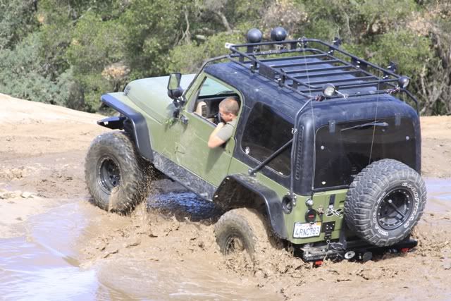

Here is something interesting. Earlier on in this thread we talked about spending money on the items needed. I seen this rig and started picking it apart the other day. This rig reminded me a lot of my previous build. I will admit right now in front of you all that at the start I had the mind set that "as long as my jeep looks tough it is tough." Sadly I was wrong...alot of money wasted down the toilet. Looking back I would have done a whole lot more research and a whole lot more thinking before purchasing. But hey, we are all guilty of buying before thinking.
In this photo notice the following...(Note: not flaming this owner ....just making a point)
1. No winch! Obviously this Jeeper has plans to possibly brave deeper water (i.e snorkle). But if the water gets real deep there is no winch to help out. Also, notice there are rock sliders...expensive item...as an expo jeep I would have gotten a winch first. Warn winch logo/tagline is ("go prepared")...something to say about that little saying!
2. Lighting - When out in the middle of nowhere additional lighting can be your best friend. Sometimes that lunch break puts you traveling to your next point in the pitch black....some added lights would help with saftey.
3. Very minor - Front bumper has eye loops for d-ring's...but I don't see any. I would have paid the little bit of cash to add them.
"The Jeep has got to be a gift from God above, it takes us to all his great hidden places and allows us to often help others in need!"
battman is offline
post #12 of 363 Old 09-07-2010, 09:30 PM
fishinjeeper
Location: around
Posts: 2,888
The LP on the front clips on to the roller fairlead. just clips off

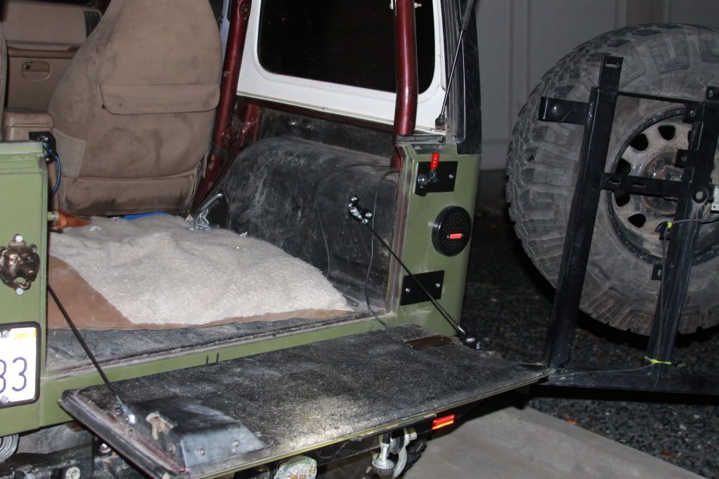

Here are some pictures of my jeep to maybe give some examples or ideas. Any issues of opinions, positive or negative are welcome.
1 Wilderness rack with 2 150 watt spots, 2 alley/side facing lights, and 2 rear lights.
2 Drop down tail gate which is a nice place to sit for a break and eat lunch. it also works great as a table for a stove or to eat.
3. 2 more 150 watt spots that are mounted near the mirrors.
4. I also have "Rock Lights" under my jeep. however, it seems I use them more as camp lights when you are not trying to totally wreck your night vision with a bright flashlight or the over heads, they provide a nice amount of light on the ground to see.
5. HAM amature radio in case I do get stranded somewhere. has MUCH better distance then a CB.
6. Winch, just in case.
7. Axe and Shovel mounted on the drivers side of the wilderness rack, and Hi lift mounted on the passenger side.
8. loyal dogs that always keep me company
