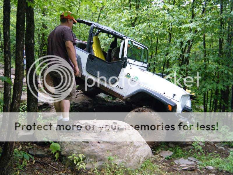

Ah-yup. Pretty much the same thing for me. Re-adjust the back straps every couple weeks or so if the flapping gets to be an issue again. Here's a pic of the bungies in action. See that nice tight rear edge?
Makes my safari top an instant "No-Flapping Zone".

I've never had 1 issue with any of my Bestop Bikini's or Safari and I ran my Safari Year round when I lived in Texas ! If you look at the pic it's nice and tight and never flapped Take the rear straps and run them under the bolts for the rear seat belts that are attached to the rollbar and back up to the strap and tighten it up mine never flapped when I had them that way !
