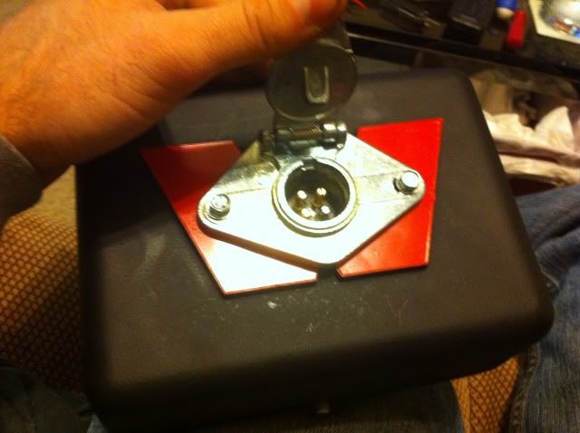

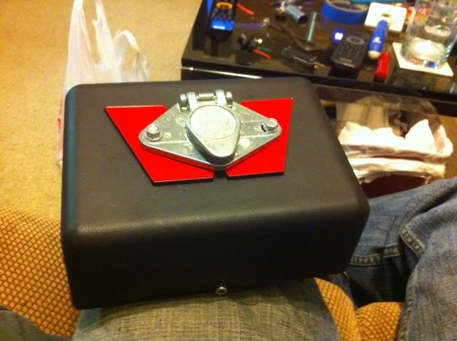

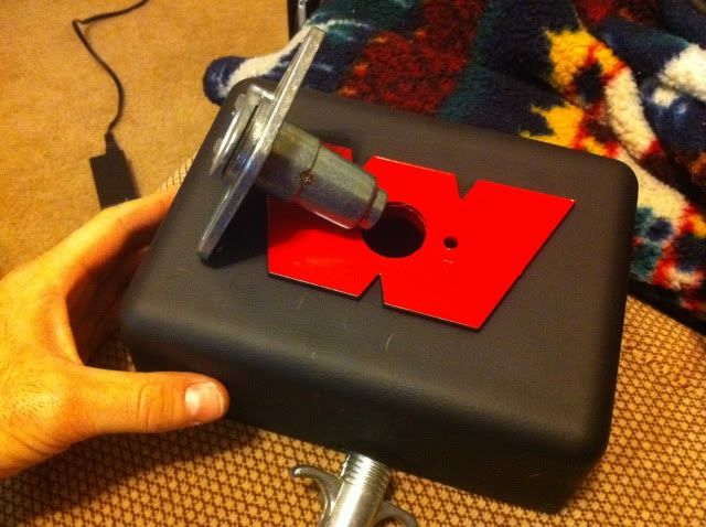

I want to give a huge thanks to Ray (1HouseMouse) for sending me the heavy duty trailer plug and socket. It's beefy and should work great. All I need to do is open up the hole on the control box cover. We have a filing station at work so it won't take too long. I plan on sealing the socket to the cover with some RTV and drill some new holes. I have some stainless steel socket head cap screws (10-32 I think) to mount it.

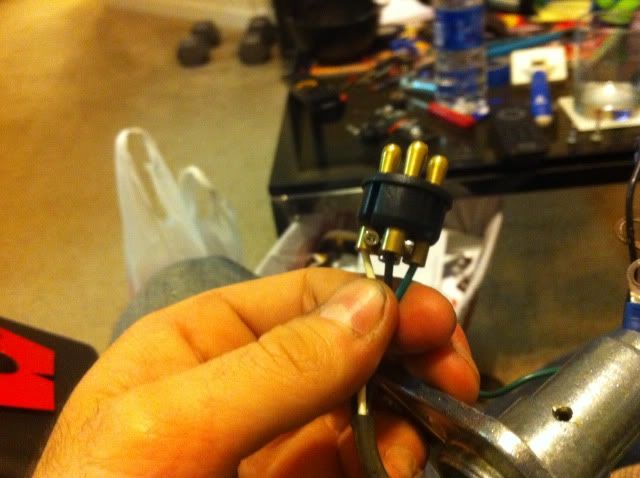

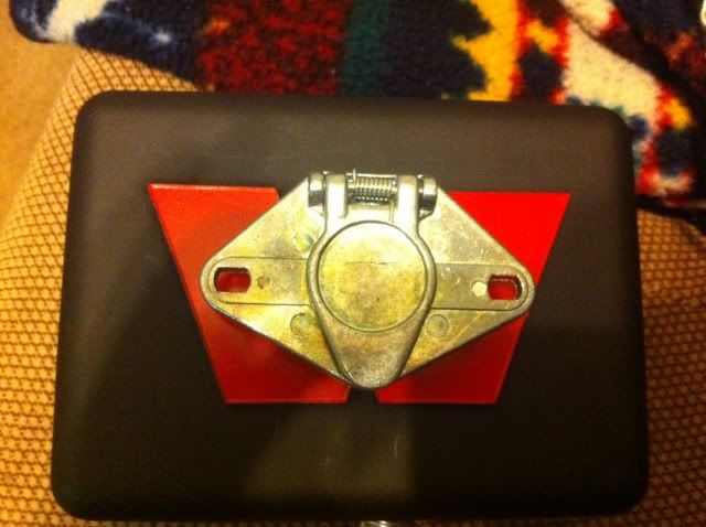

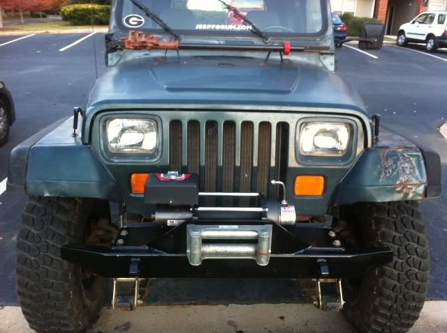

Well I got the control box done and everything wired up. I just need to bolt up the winch and attached the leads. The heavy duty trailer plug and socket worked great. I've attached a pics below. All I had to do was file out the hole where the other plug was and I put some self tapping screws in the housing. I'll need to wire the plug to the remote but I'm not sure which wires control in and out. I think my buddy has my voltmeter so I'll just have to do a little trial and error.

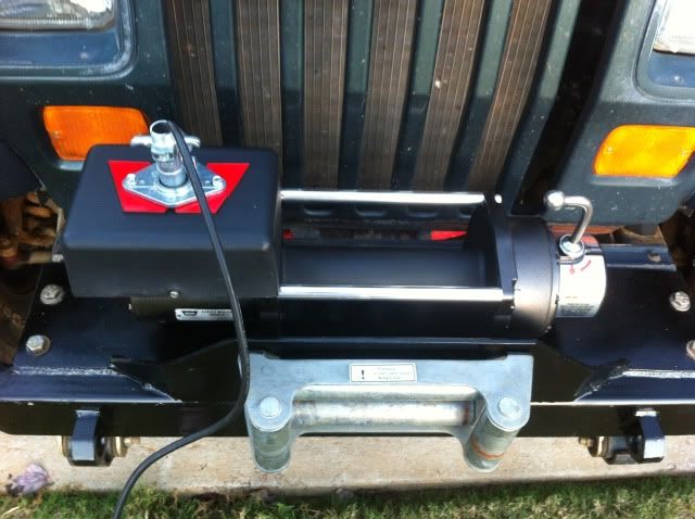

Well I'm 99% done. I just need to put some wire rope on the drum. The trailer plug and socket works great and the winch works good (from what I can tell).
Lou

Louie, you did an absolutely amazing and totally thorough rebuild. VERY nice job man, Kudos to you!
