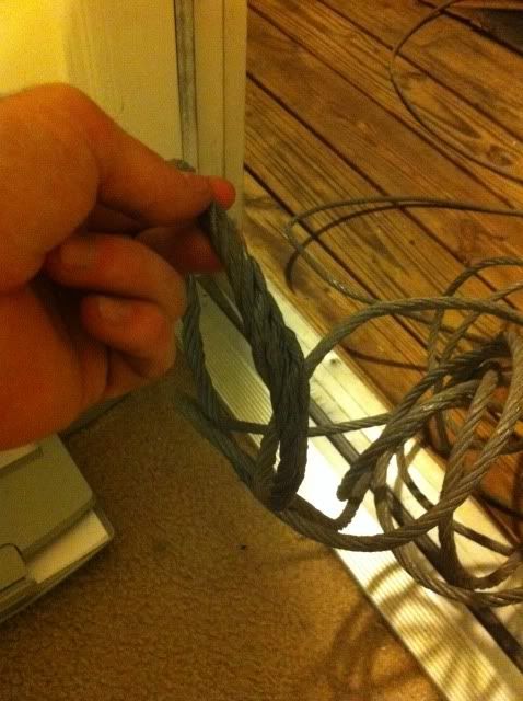

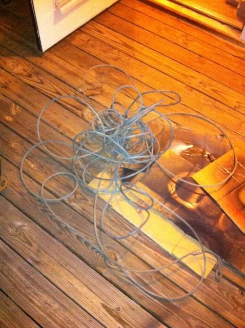

Here's a kink in the cable. There is also flattening of the cable that was wrapped around the drum. It wouldn't hurt to replace but a good cleaning and lubricating and I could get some more pulls. I'll probably go ahead and get a new cable though.
The birds nest.
The kink.

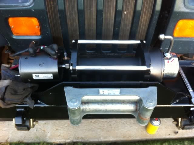

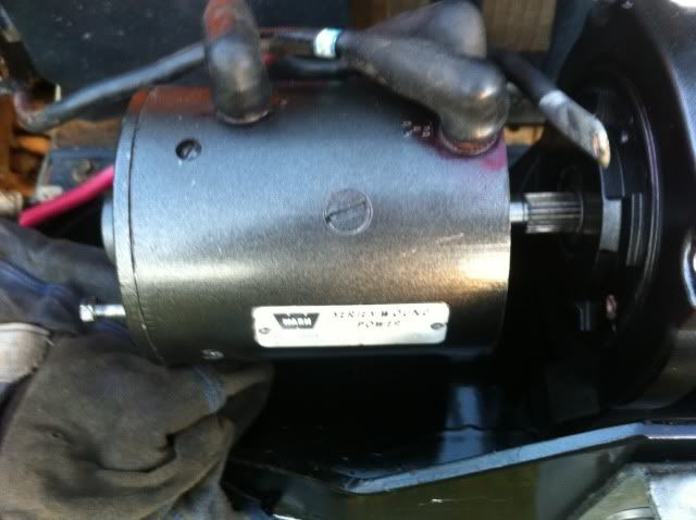

Well I got some bad news guys.
I got my bumper touched up with paint and wanted to get the winch on before it got a little cold and rainy. The weather has been awesome and I wanted to take advantage of it. In order to take my winch on and off I had to take the bumper off. I got the winch and bumper on and I wanted to test the motor to make sure it worked. Well it didn't. As a matter of fact it sparked when I tried hooking some jumper cables up to it. I had the case grounded on the bottom and I hooked a positive lead to one of the post closest to the drum and the negative to the outer post.
So now I have a few possibilities for the problem.
-I don't have any idea how to put power to the winch motor.
-The motor is toast and is grounding out somewhere.
-I assembled the planetary gears incorrectly causing it to lock up.
Well, I figure I tried several ways to power it and nothing so that might be ruled out. The motor being toast is a great possibility. As for the planetary gears, I don't think so because I followed every picture of a rebuild I could find on the web. Here's my next thought. The drum is locked up when it's engaged. I figure that's because the motor isn't turning the coupler inside the drum to release the brake therefore it's locked up. If the motor is toast it won't unlock the drum.
If anyone sees flaws in my logic or wants to throw out some ideas I'm all for it. A few pics of the winch on the bumper. Looks like that new cable may have to wait until I get a new motor.

OK, I'm a 'tard.
I watched a video on testing an M8000 Warn winch. I did not jumper the terminals from the armature to F1 then power F2 then reverse armature to F2 and power F1. Now I remember why I didn't go into electrical engineering. As a matter of fact I'm an Agricultural Engineer. Even more surprising is I design electrical substation connectors for high and extra high voltage.
One thing to take away from this is google is your friend. I'll post back if it works and I believe it will now that it will be wired correctly.

Another question for you guys. I saw a rebuild of an M8274 on youtube and the guy sealed his electric motor to the housing and the back cover with RTV. I have the motor off, should I do this?
Lou
Don't think it would hurt.

I was getting ready to asked if you'd used a jumper... Trust me, you're not the first to do that. I did the same thing after I went through the motor on a Smittybilt. It shorted bad enough that I had to chase the threads with a die/tap before I could bolt the lead back on. The upside is that once you make that mistake, it leaves an impression and you won't make it again.
I highly recommend sealing the connections (housing side and cap side as well). I had a Ramsey on a CJ that I know had never been submerged, but I never put a cover over it. It started giving me problems and when I opened it up, there must have been two cups or so of water inside (foul nasty water). A little cleanup with contact cleaner and a nylon brush took care of it. After that I sealed it and tore it down the following year (I was starting to worry that I might have created a situation where water could seep in and not be able to get out), but it was dry and pretty inside.
