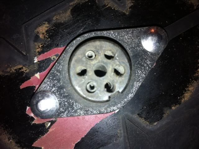

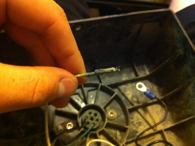

I need to find a female pin connector. One of mine was caved in on itself which would explain why the controller would sporadically not work. I'm hoping I can find something at Radioshack.
Lou
I would think that you could use the pin from a trailer connector, but I don't know for sure.
Also, you might want to check out Pierce Sales. You can get a solenoid pack (2 double throw continuous duty solenoids that are intended for industrial winches) as well as the plug, remote, and solenoid to motor cables all for $60... Even if you just used the plug and the controller, that's not a bad deal and you'd have a backup option for your solenoids.
Here is a link... http://www.piercesales.com/Solenoid-...e-p/ctl013.htm
