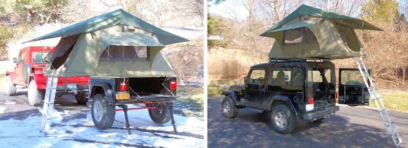

I'd also like to consider a roof-top tent, but I that's a later purchase. Any particular tent that you're looking at?
Here's the one I have, I've had it on my Dinoot Jeep-tub trailer and on top of my Jeep, and it's about to be mounted on the military trailer too...
Here's where you can get it, I highly recommend it and the company that sells it: http://compactcampingconcepts.com/St...f-toptent.html
