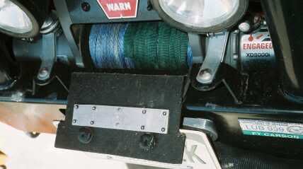

I live next door to a Tow Boat US guy with several boats that do recoveries every day and they only run synthetic rope, if its good enough for them... As for the winch I like my Warn XD9000i just fine, got it used and partially dissassembled for $280, threw probably $40 in parts at it and it works like a champ.

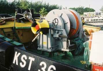

Wonder what the in service life is, of that rope on the tug?
Wouldn't mine have'n a 100' or so length of syn rope, as a winch cable 'extension' that I can keep in a bag.
BTW, my son sez they only use steel cable because the unloaded syn rope goes crazy in the rotorwash even when weighted. The steel cable just 'hangs'.
