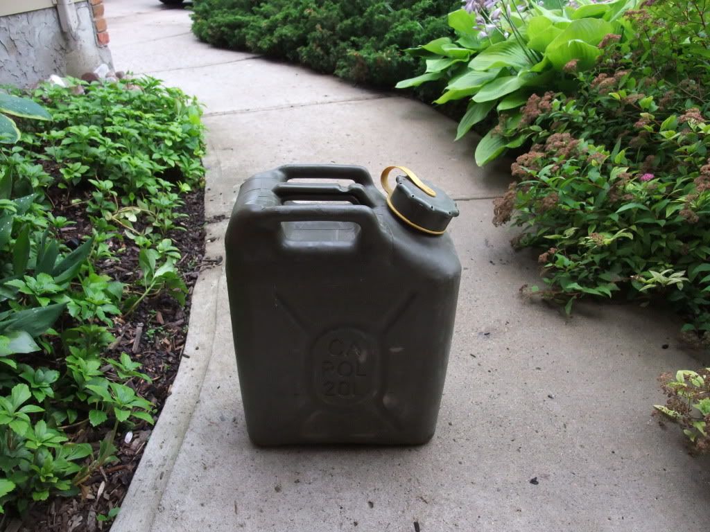

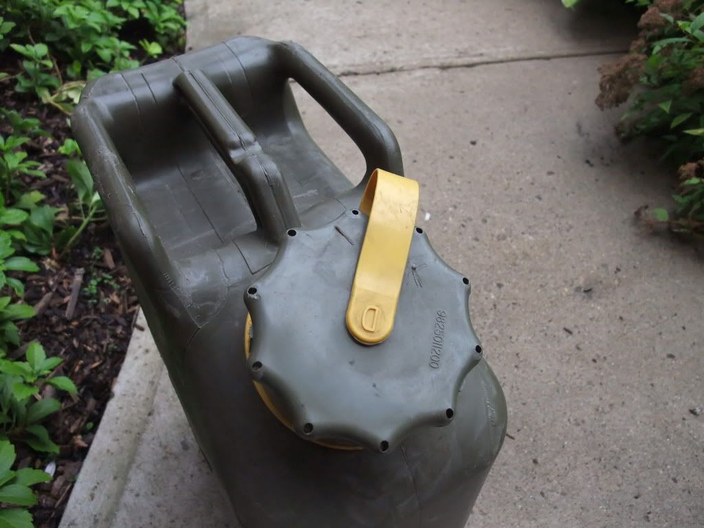

The best cans, by FAR, are of the Scepter Mil-Spec variety. Somewhat difficult to find in the states, but worth looking for.
This is my diesel one, the gas ones use a red strap.

Incredibly tough. One of the guys on my local forum drove over a full one (in a big, heavy Land Cruiser) with zero repercussions. If they're good enough to be Mil-Spec, they're good enough for me.
If you ever venture over to forums like Expedition Portal, they are the ones that everyone wants.

Aside from color of the plastic strap, is there a difference between a gas can and a diesil can? Can I buy either/or and paint the strap as needed?

The seals are also different. The diesel cans came with rubber seals and the gasoline cans use viton ones. Don't put the wrong type of fuel in the container or you risk swelling the seal and cracking the cap (the caps are very expensive).
Fortunately, making your own seal for whichever fuel you prefer is straightforward.

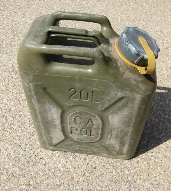

Yeah, Scepters are the best. You MAY be able to find them on Ebay occasionally. About $50 for a used, slightly scratched one. They put all other fuel canisters to shame.
Here's mine. Scratched but tough as nails:
I don't have a nozzle for the Scepter. I just use a plastic gas tank insert and then stick a funnel in that and pour it right in.

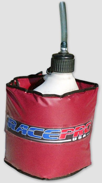

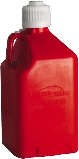

Another interesting variation on the fuel can is the white/translucent square shaped motocross/racing plastic canisters. Don't have a picture but they have the clear plastic tubing coming off the top which allows the entire 5 gal container to empty much faster than most cans. Downside is they aren't standard shapes and thus have to stored in a trunk or other rack with the caps tightly on:
Like the Scepters, they never leak and actually are easier to use than the Scepters. Perhaps not quite as bulletproof, and they won't fit in a standard carrier.
