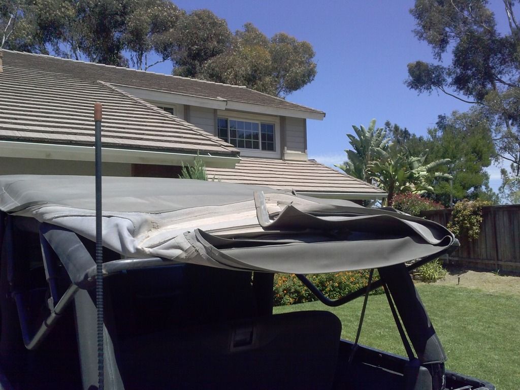

Start with the top folded down

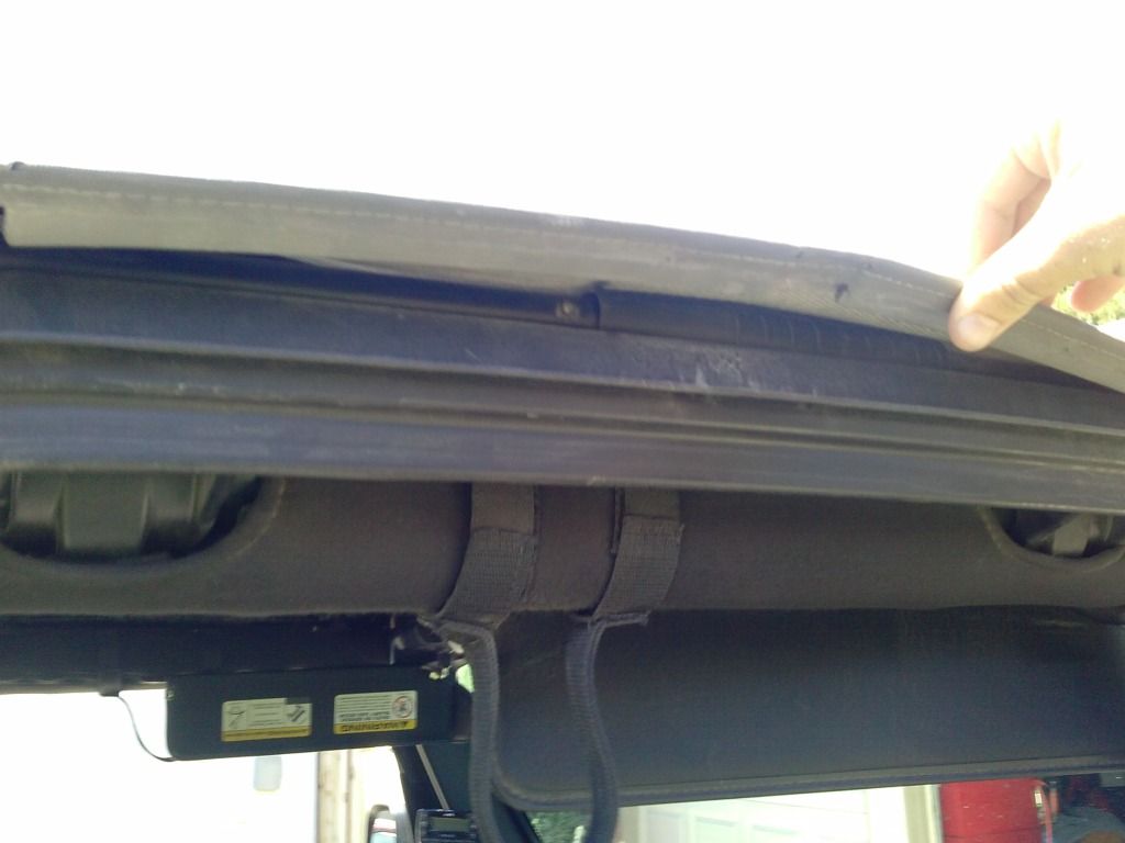

Bring the header to the connection at the windshield and leave everything loose. The rear pillars are folded inward on mine to be folded down easier

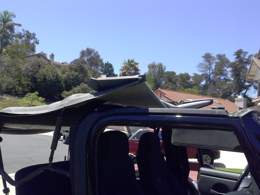

The front sunrider section will have hinges like the trektop does. Make sure it is not folded back like shown below
The front should be like this

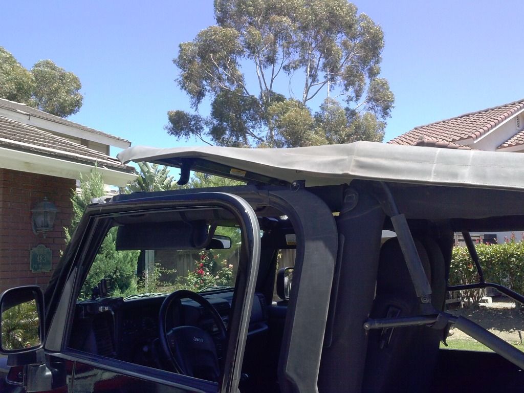

Header connection

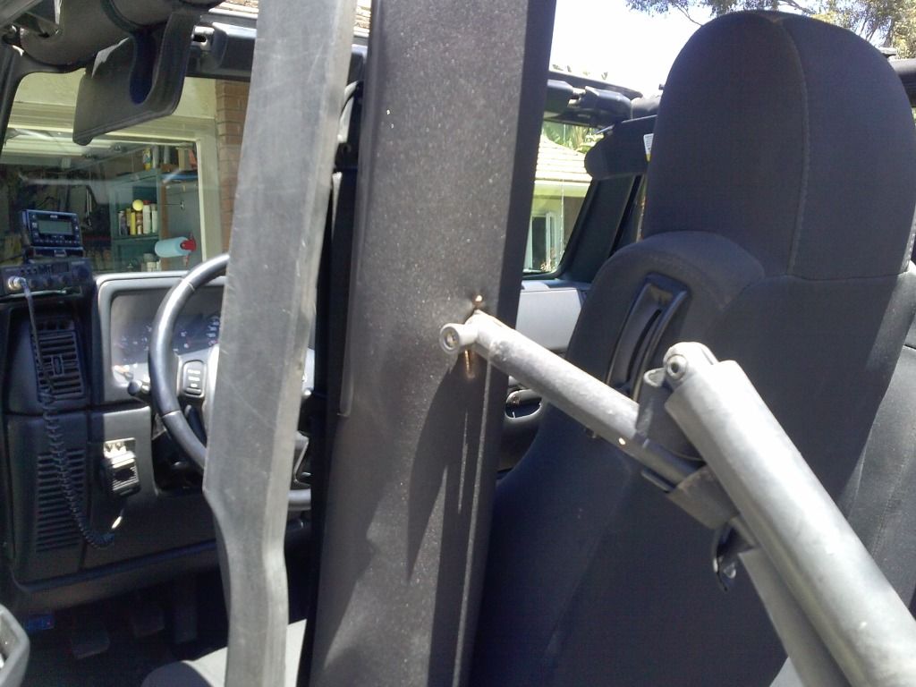

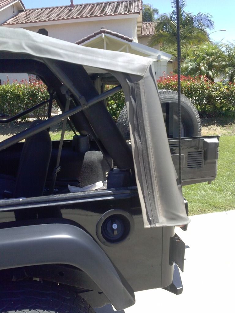

Once the header is connected, install the rear pillars
The hardware should resemble this before you install the windows
After those are connected, connect the 2 side windows
Clip these into the door surrounds after the side windows are installed
