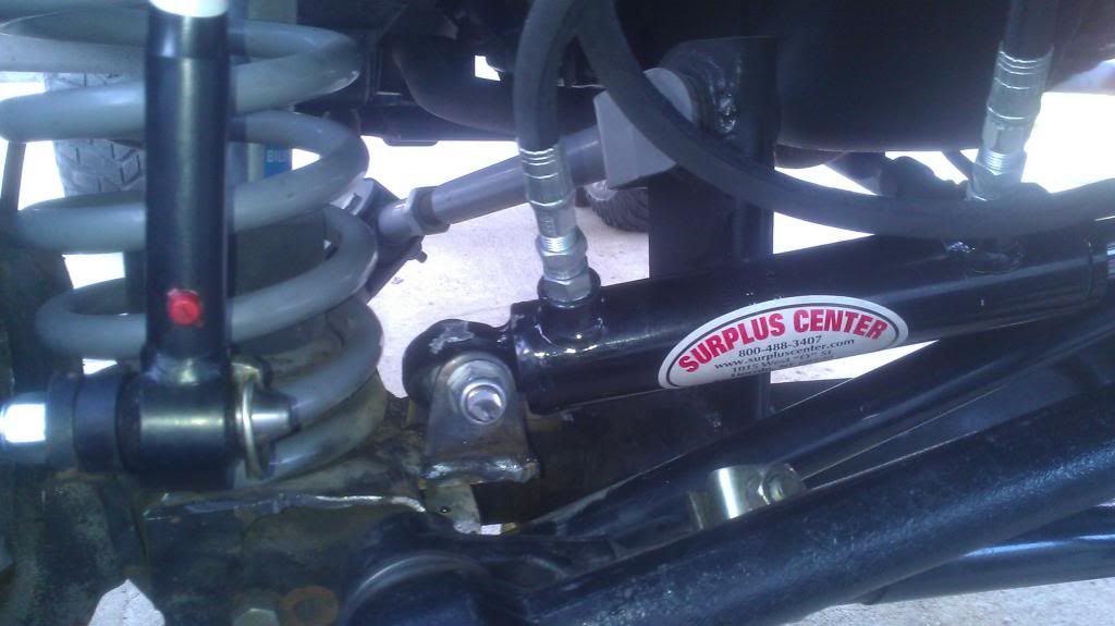

Kevin,
here's a pic of my setup. obviously i got the parts at surplus center. i think i got the lines thru Grainger, i dont recall exactly, its been a while
It was as simple as cutting off the bracket for the stabilizer, welding on a 3x4" plate with tabs for the ram, then a piece of channel on the drag link (i couldnt get it to fit on the tie rod with my setup) with some tabs on it. I'm currently running 90deg fittings and shorter lines. that was put on just to get it running, IE trial fitment/run. anyways, its a 3-4 beer project. the hardest part really was the steering box. and it wasnt really hard as it was time consuming. plus i'm horribly color blind and had a helluva time figuring out the different colored ball bearings.
anyways, you get the idea. its pretty basic, and there's a lot of us with welders and a drinking problem..
oh yea, for what its worth, i cant even tell its on there on the freeway. the only time i can tell its there is when i'm parallel parking, because its REALLY easy to turn those 36" swampers compared to stock. lol I'll see i have some pictures of the box somewhere, i'm pretty sure i do.

Originally Posted by premo View Post
Kevin,
Gonna need your help with this on both of my jeeps.
