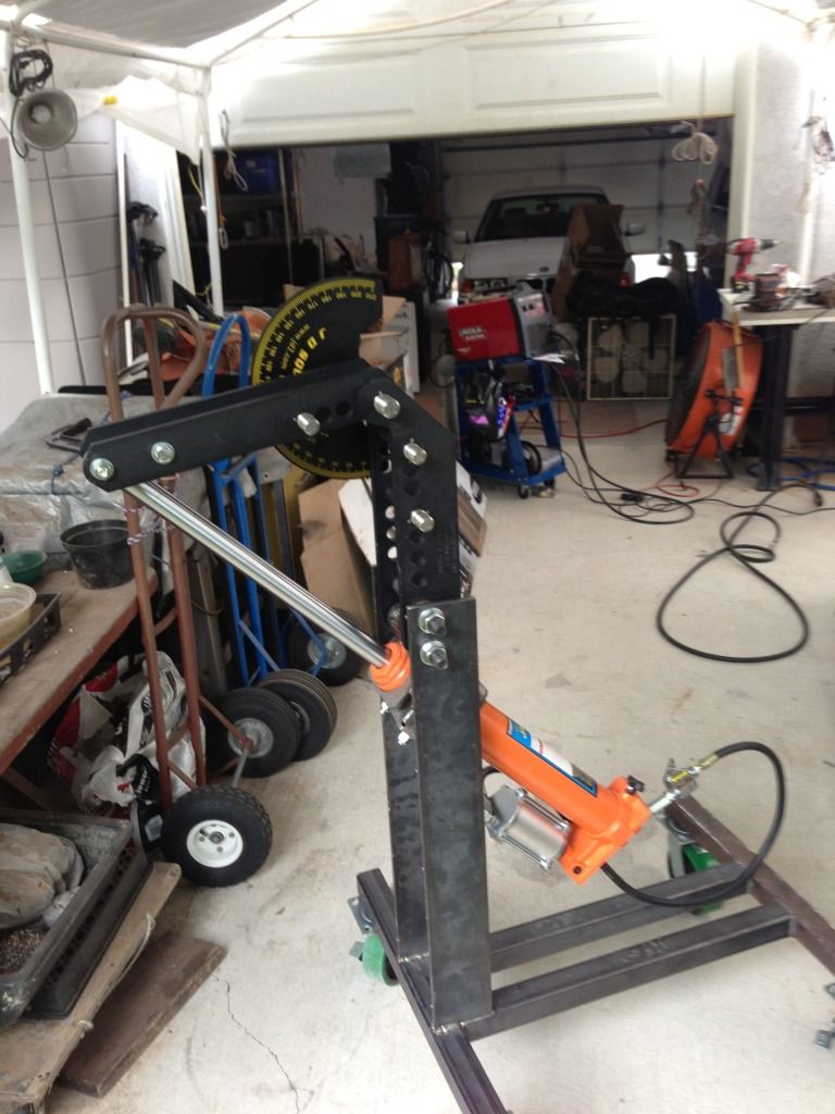

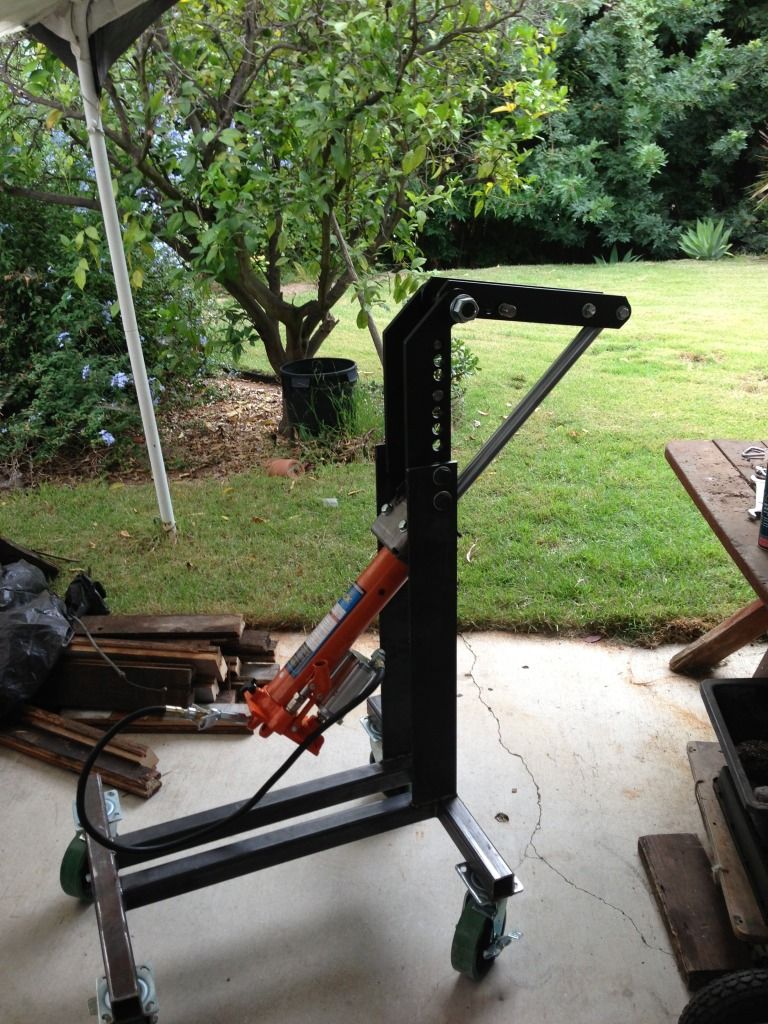

Sorry about Saturday Joe. I ended up getting hung up and didn't get much done.
Got the bender all finished up today though.
Had to source some longer bolts to space the support brackets out enough to fit the swing arm for the ram.
Now it just needs a die

Is that ram made for it or is that built?

It's an HF 8 ton air/hydro ram I got with a 40% off coupon.
The mount is the Swag OffRoad ram mount. It works with the standard sideways mounting of the JD2 as well as like this.
I only built the vertical mount so I could move it around.

No worries. Looks like the stand came out well.
BTW: Looks like you painted it the same color as my brake/axle stuff.

it will get painted. I just got it bolted together. I'll tear it down for paint not sure what color... something to compliment the HF orage

Vertical is better. We had ours flat and it took forever to bend. With it vertical the oil stays in the bottom and bends way faster.
