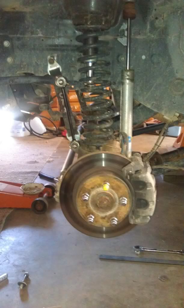

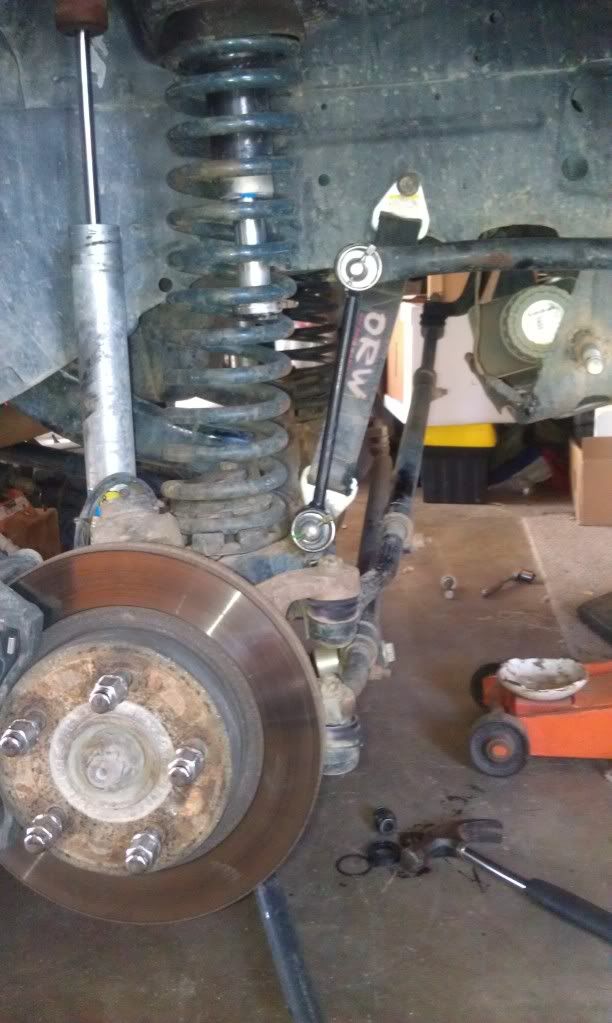

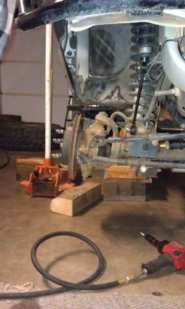

s promised, pictures of the damage. It doesnt look as bad as I thought. Removing the track bar helped to straighten some of it out.
The drivers knuckle and steering wheel are both at straight ahead.
Passenger side
Drivers side
My coils have always touched my bump stops at full droop, That is why i have it strapped. The drivers side looks to be normal to me but the passenger appears to be a inch or so pushed back.
I plan to pull the axle to inspect everything. Are there any measurements I need to take as referance before I pull this old axle in the event I put a different one in?

take some pics at ride height
