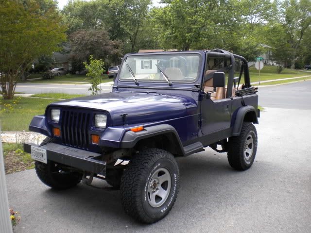

Painted the dash and rollbar pads with black vinyl/fabric spray and going to be making seat covers soon.
Before
After
