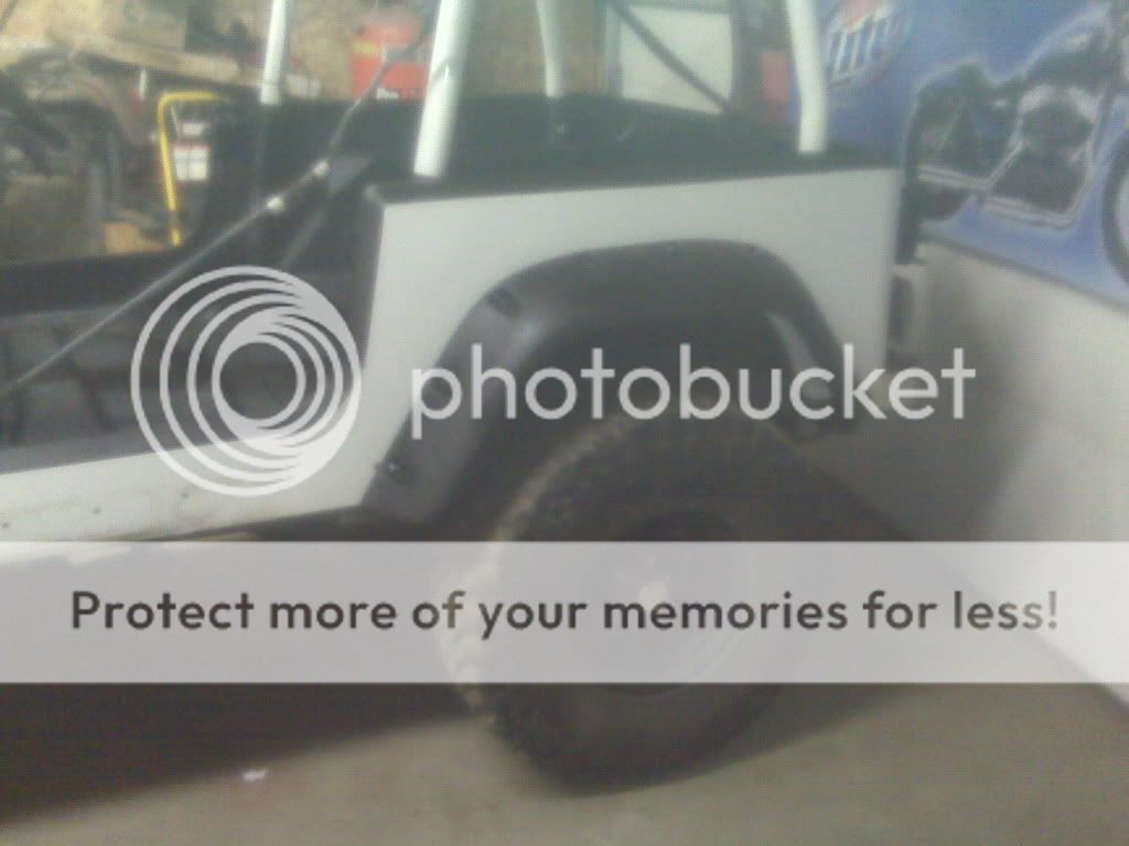

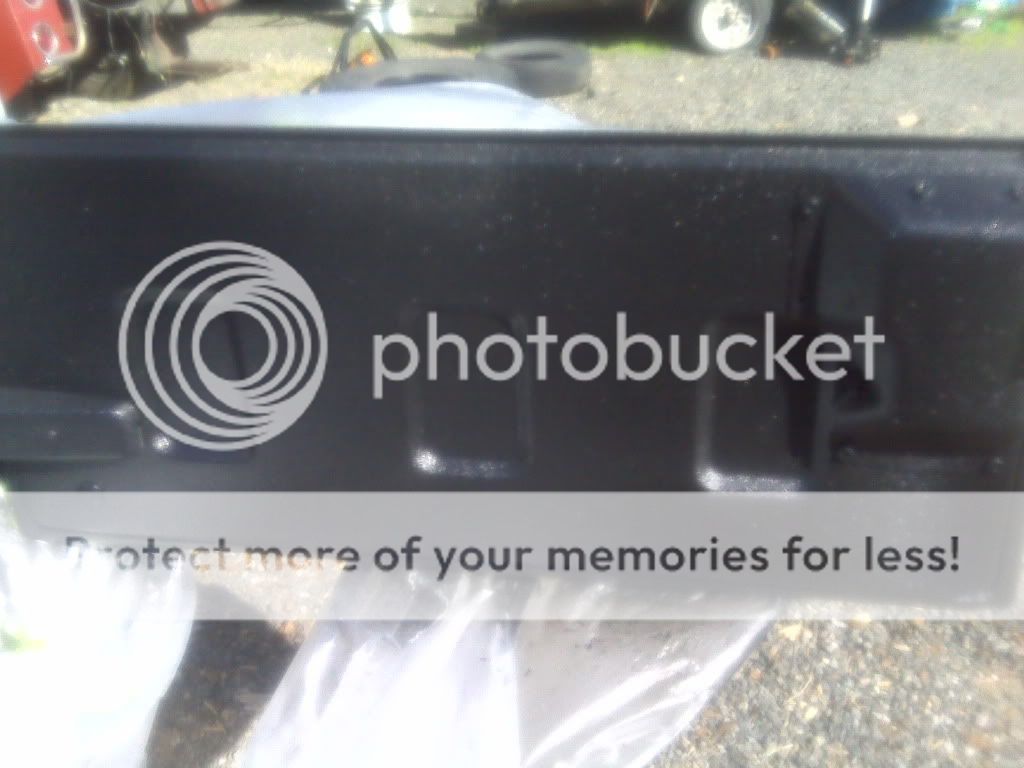

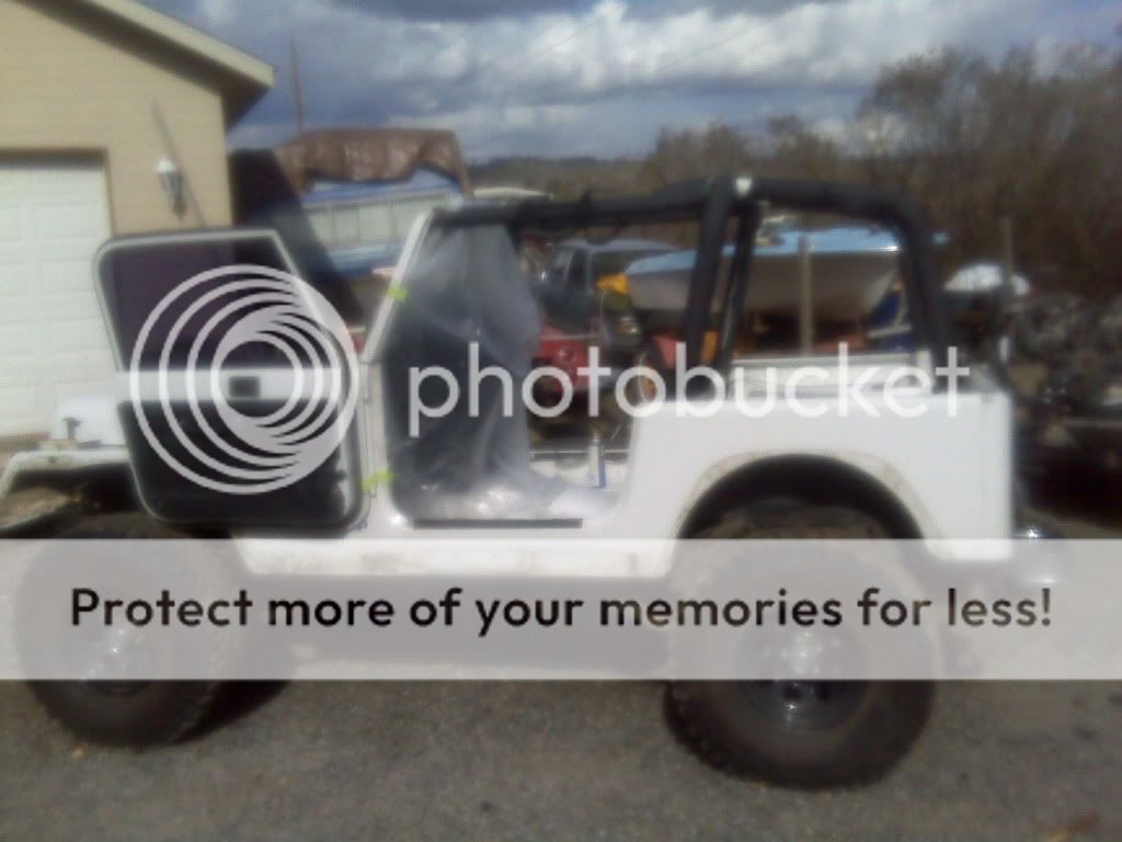

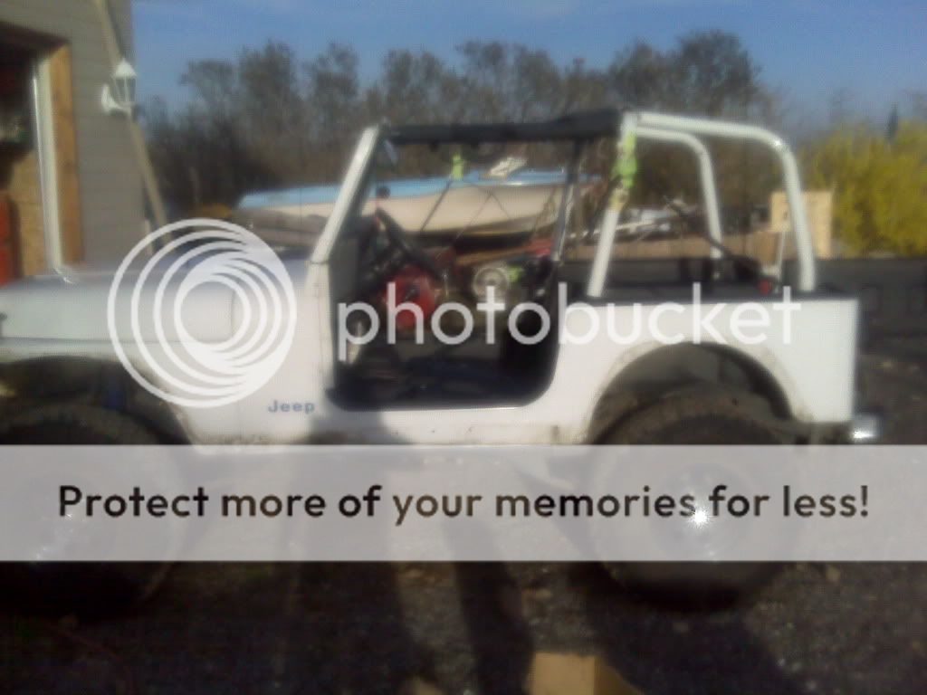

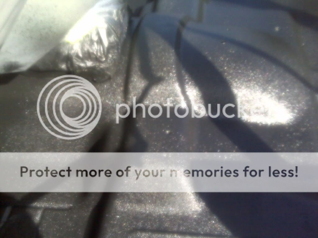

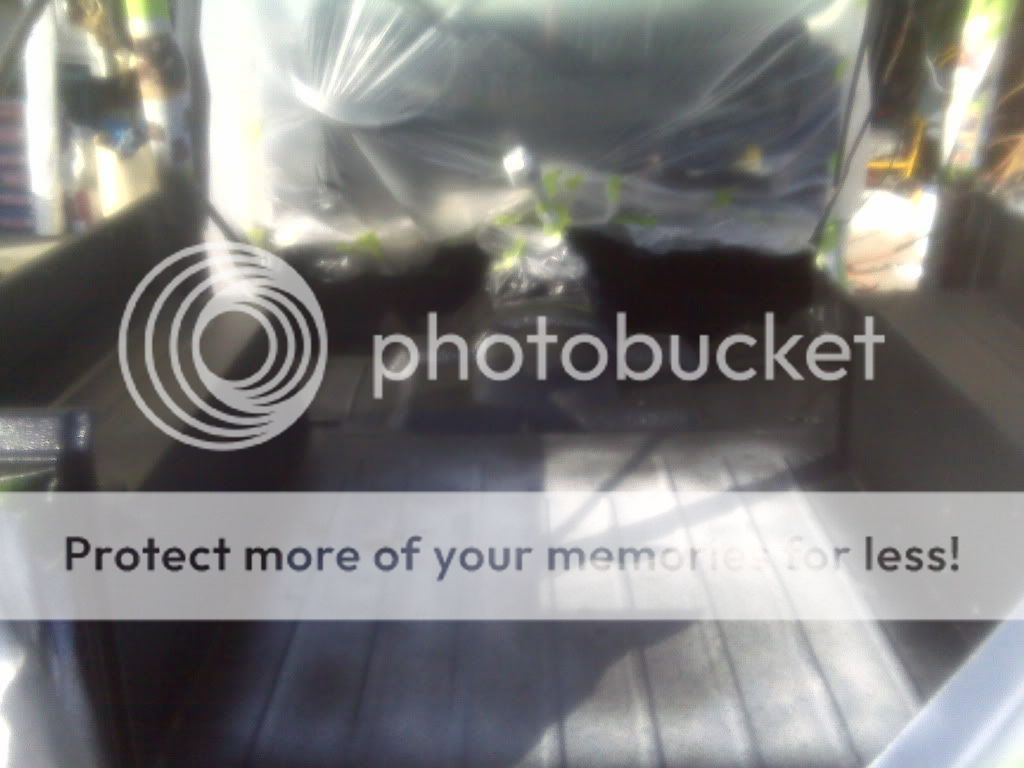

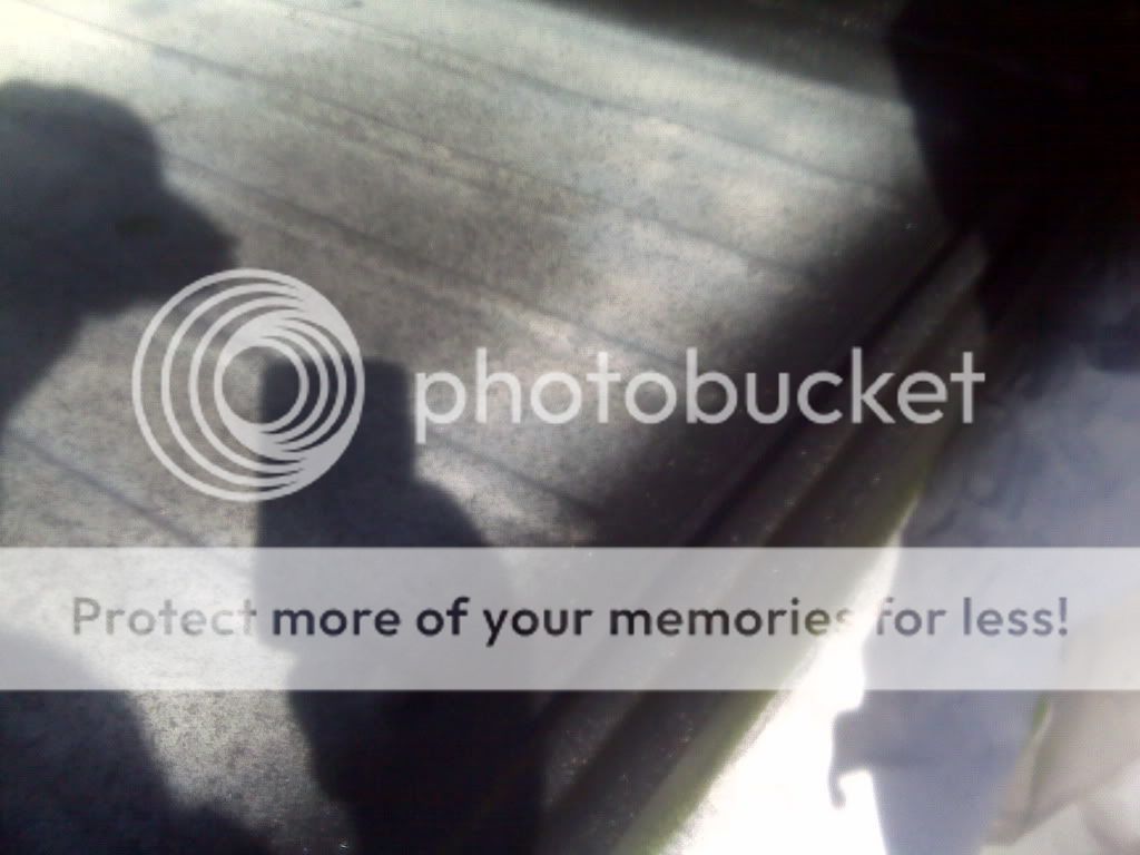

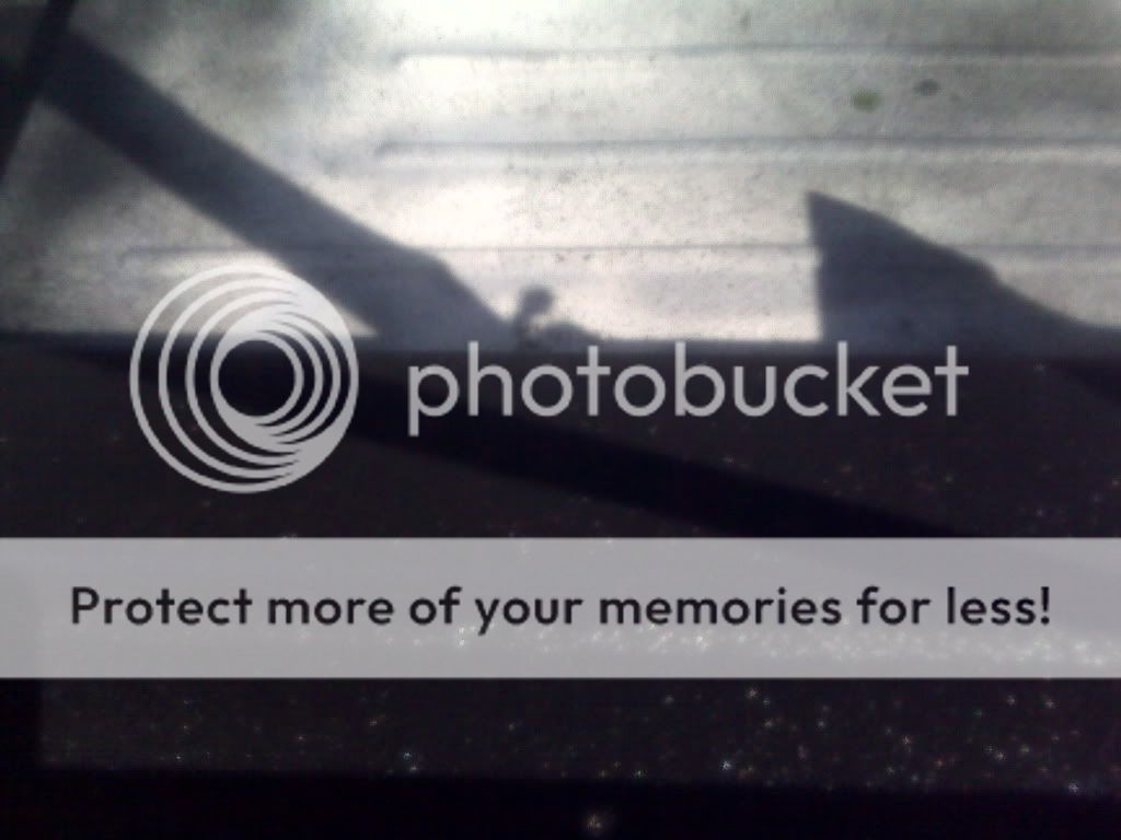

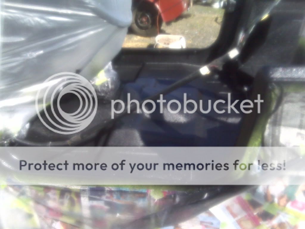

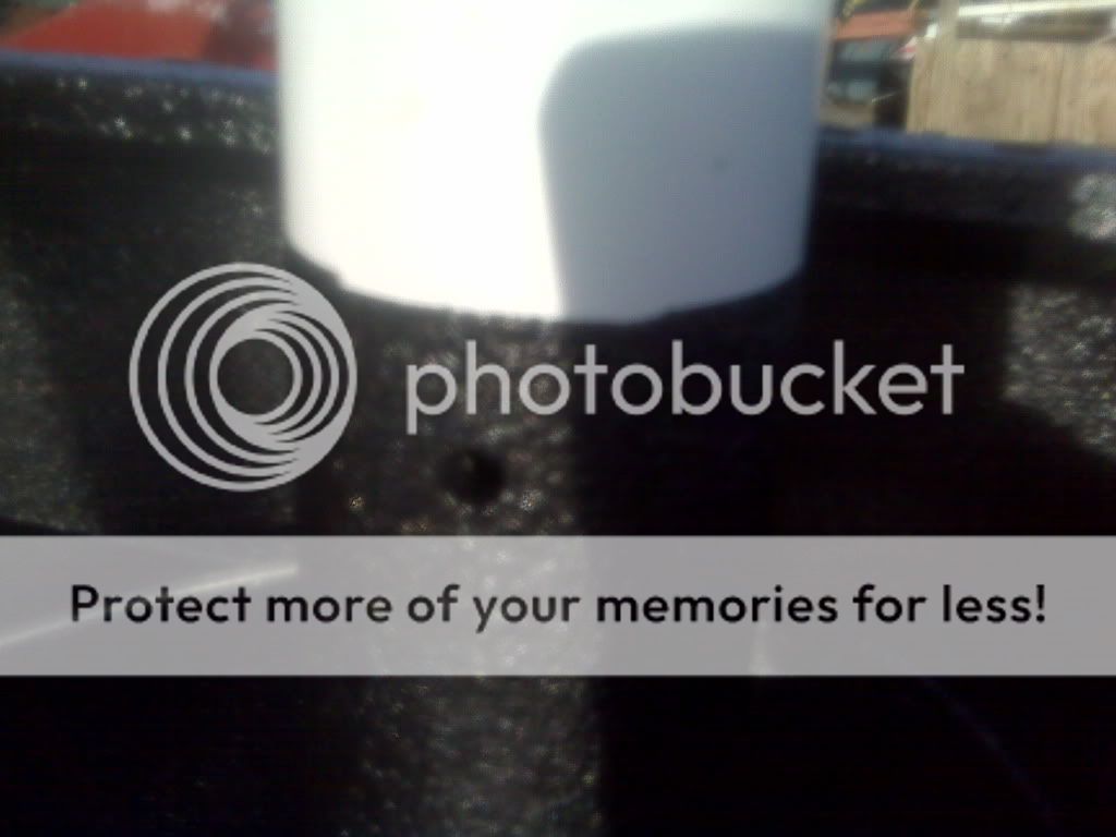

i used the upol raptor, that stuff is awesome!!!! i used painters tape
did the fender flares to
